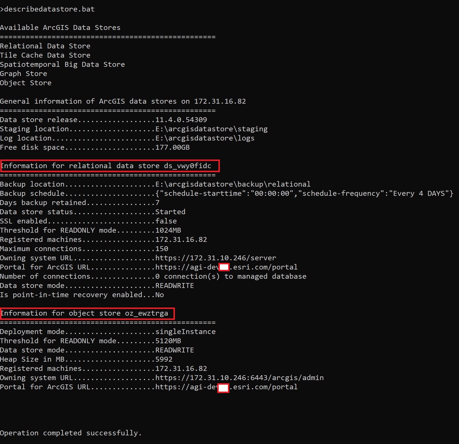

C:\Users\Administrator>cd C:\Program Files\ArcGIS\DataStore\tools
C:\Program Files\ArcGIS\DataStore\tools>describedatastore.bat
Available ArcGIS Data Stores
Relational Data Store
Tile Cache Data Store
Spatiotemporal Big Data Store
Graph Store
Object Store
General information of ArcGIS data stores on 172.31.16.82
Data store release..................11.4.0.54309
Staging location....................E:\arcgisdatastore\staging
Log location........................E:\arcgisdatastore\logs
Free disk space.....................167.00GB
Information for relational data store ds_vwy0fidc
Backup location.....................E:\arcgisdatastore\backup\relational
Backup schedule.....................{"schedule-starttime":"00:00:00","schedule-frequency":"Every 4 DAYS"}
Days backup retained................7
Data store status...................Started
SSL enabled.........................false
Threshold for READONLY mode.........1024MB
Registered machines.................172.31.16.82
Maximum connections.................150
Owning system URL...................https://172.31.10.246/server
Portal for ArcGIS URL...............https://agidev.esri.com/portal
Number of connections...............0 connection(s) to managed database
Data store mode.....................READWRITE
Is point-in-time recovery enabled...No
Information for tile cache data store tcs_608l5ody
Data location.......................E:\arcgisdatastore\nosqldata
Data store status...................Stopped
Backup location.....................E:\arcgisdatastore\backup\tilecache
Backup schedule.....................{"schedule-starttime":"01:00:00","schedule-frequency":"Every 15 DAYS"}
Deployment Mode.....................cluster
SSL enabled.........................true
Member machines.....................172.31.16.82
Owning system URL...................https://172.31.10.246:6443/arcgis/admin
Information for object store oz_ewztrga
Deployment mode.....................singleInstance
Threshold for READONLY mode.........5120MB
Heap Size in MB.....................5992
Operation completed successfully.

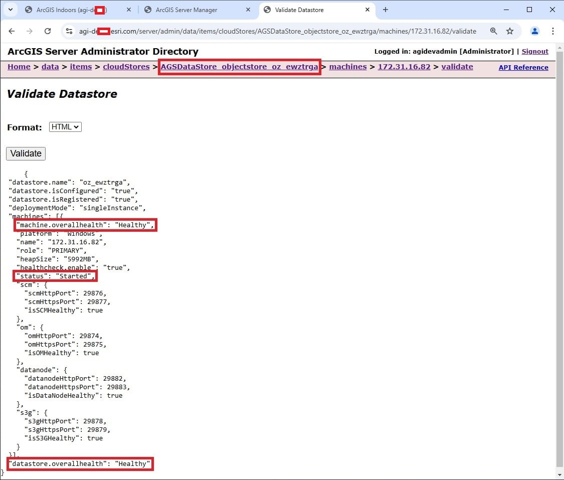

1.3) Validate Data Stores
Server Manager > Site > Data Stores > Validate All
All data stores validate fine.

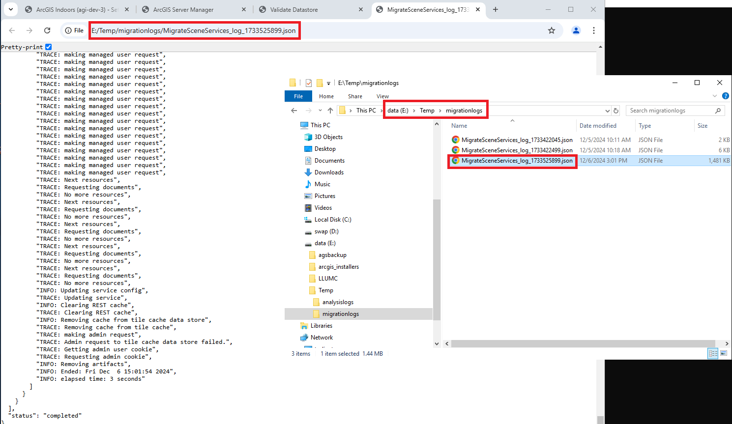

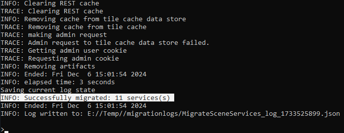

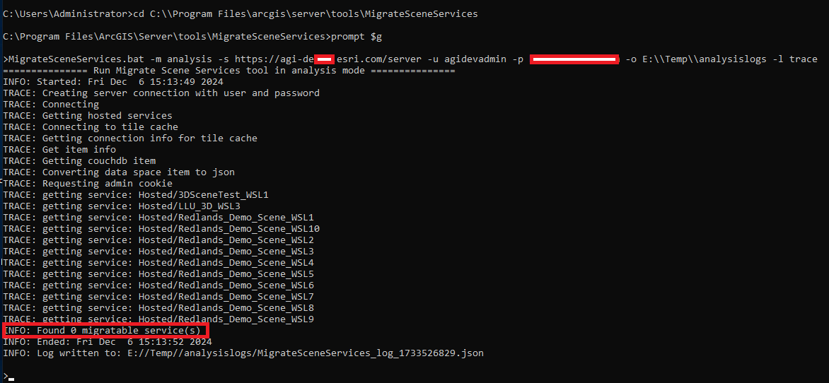

The workaround resolved the issue and the MigrateSceneServices.bat analyze finished very quickly now and the json output file "MigrateSceneServices_log_1733272379.json" was created as well.
cd C:\\Program Files\arcgis\server\tools\MigrateSceneServices
> MigrateSceneServices.bat -m analysis -s https://agidev.esri.com/server -u agidevadmin -p ****
    -o E:\\Temp\\analysislogs -l trace
=============== Run Migrate Scene Services tool in analysis mode ===============
INFO: Started: Tue Dec 3 16:32:59 2024
TRACE: Creating server connection with user and password
TRACE: Connecting
TRACE: Getting hosted services
TRACE: Connecting to tile cache
TRACE: Getting connection info for tile cache
TRACE: Get item info
TRACE: Getting couchdb item
TRACE: Converting data space item to json
TRACE: Requesting admin cookie
TRACE: getting service: Hosted/LLU_3D_WSL3
TRACE: set db
TRACE: getting doc keys
TRACE: making admin request
TRACE: Getting cache information
TRACE: getting service: Hosted/Redlands_Demo_Scene_WSL1
TRACE: set db
TRACE: getting service: Hosted/Redlands_Demo_Scene_WSL10
TRACE: set db
TRACE: getting service: Hosted/Redlands_Demo_Scene_WSL2
TRACE: set db
TRACE: getting service: Hosted/Redlands_Demo_Scene_WSL3
TRACE: set db
TRACE: getting service: Hosted/Redlands_Demo_Scene_WSL4
TRACE: set db
TRACE: getting service: Hosted/Redlands_Demo_Scene_WSL5
TRACE: set db
TRACE: getting service: Hosted/Redlands_Demo_Scene_WSL6
TRACE: set db
TRACE: getting service: Hosted/Redlands_Demo_Scene_WSL7
TRACE: set db
TRACE: getting service: Hosted/Redlands_Demo_Scene_WSL8
TRACE: set db
TRACE: getting service: Hosted/Redlands_Demo_Scene_WSL9
TRACE: set db
INFO: Found 11 migratable service(s)

6) Data Store Tile Cache Migration Execution
The report generated from running the utility in analysis mode indicates that the deployment is configured to allow migration and that there are scene layer caches to migrate.
Then, run the utility in execution mode.
> MigrateSceneServices.bat -m execution -s https://agidev.esri.com/server
-u agidevadmin -p ***** -o E:\\Temp\\migrationlogs -l trace
After all scene layer caches are migrated and tested, run the utility one last time in analysis mode to confirm no caches remain that need to be migrated.

After all migrated scene layers have been tested and confirmed to function, the ArcGIS Data Store administrator runs the disabledatastore utility to unregister the tile cache data store from the hosting server and delete all its contents.
--Log into the Data Store machine--
disabledatastore.bat --store tileCache
