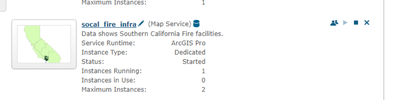

arcpy.server.UploadServiceDefinition(inSdFile, inServer)
ArcPy needs 2 input parameters one is ArcGIS Server connection file, and one is Service Definition which is created using ArcGIS Pro.

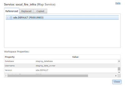

At the end it publishes service in staging environment in root folder for ArcGIS Server:
The service is published with referenced database:

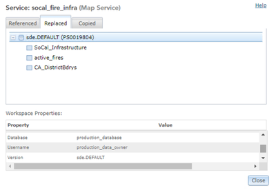

  • Production Environment: Configure ArcGIS Server in a following way:
Publisher database connection should be configured with credentials of data owner from staging database. Server database connection should be configured with production data owner credentials.
Now by executing same line of ArcPy based python code, the service is published in production environment. The service is published with replaced dataset, where staging credentials are being replaced by production:

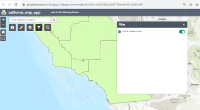

  • Web Mapping Application: The web mapping application can be created/configured in lower environment. Once web application is being created it can be cloned/copied from lower environment to production using ArcGIS API for python. The code can be executed from orchestration machine.
from arcgis.gis import GIS
sourcePortal='https://staging.esri.com/portal'
sourceUserName='portaladmin'
sourcePassWord='Source2018'
targetPortal='https://prod.esri.com/portal'
targetUserName='portaladmin'
targetPassWord='Target2018'
source = GIS(sourcePortal, sourceUserName, sourcePassWord, verify_cert = False)
print("Connected to Source Portal " + sourcePortal + " as "+sourceUserName)
target = GIS(targetPortal, targetUserName, targetPassWord, verify_cert = False)
print("Connected to Target Portal " + targetPortal + " as "+targetUserName)
item_mapping={}
item_mapping['d4038035da9c4850980d0eec723d5fc1']='6481d82b0597403ab31c2a68487e473d'
source_item = source.content.get('1e2d62518d8940dcaf5a077cf8f4e6db')
target_item = target.content.clone_items(items=[source_item],owner=targetUserName,
                                                 item_mapping = item_mapping,
                                                copy_data=False,
                                                search_existing_items=True)
print('Item is clonned with ID:' + target_item[0].id)
We need 3 IDs to make this happen:
  • Item ID of non-hosted feature service in Source environment which in this example is 'd4038035da9c4850980d0eec723d5fc1'
  • Item ID of non-hosted feature service in Target environment which in this example is ' 6481d82b0597403ab31c2a68487e473d'
  • Item ID of web map in Source environment which in this example is ' 1e2d62518d8940dcaf5a077cf8f4e6db'
Congratulations, you have successfully promoted Web Mapping Application from staging to production using automation script and application is fully working with all widgets in production environment:
