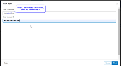

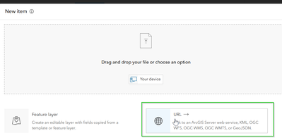

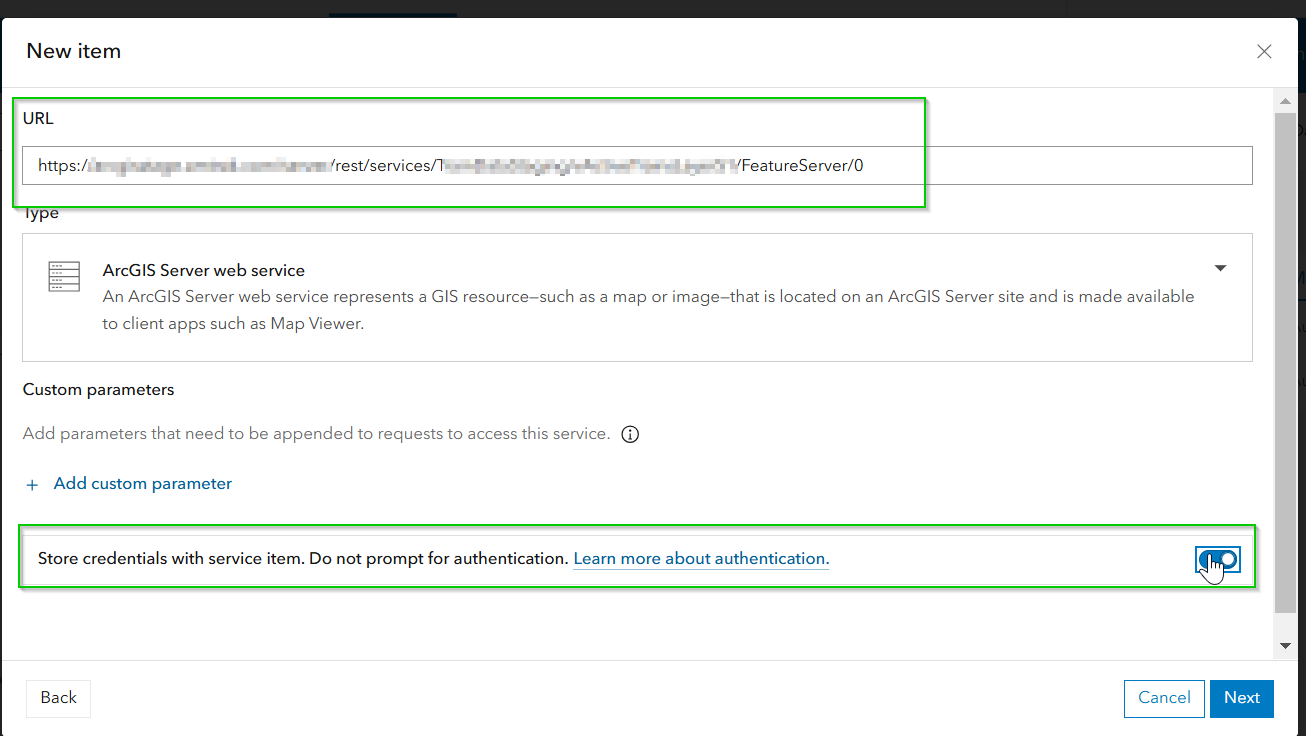

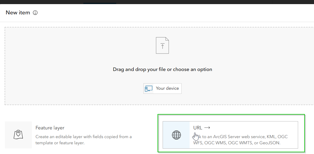

content> add item:
add the Feature Service url

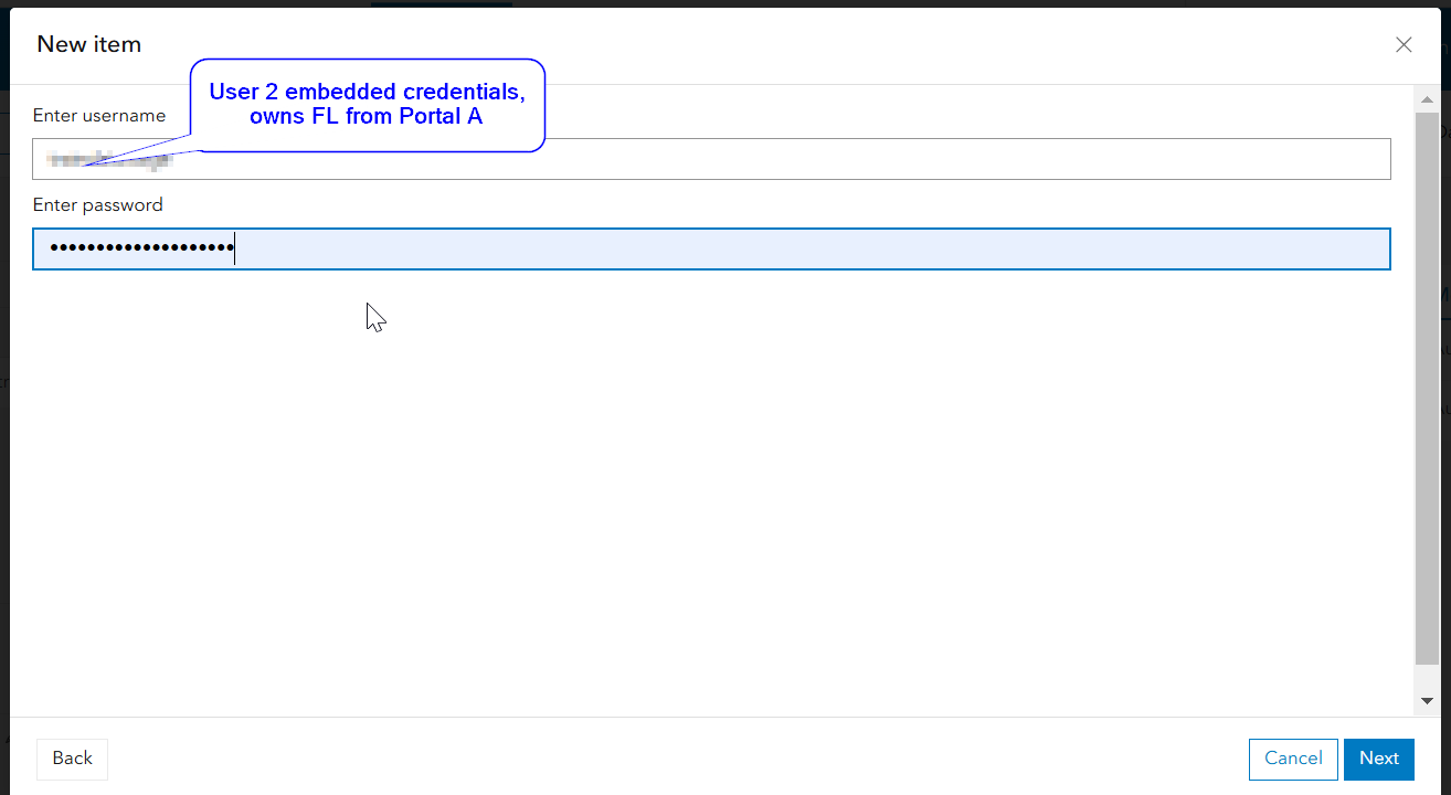

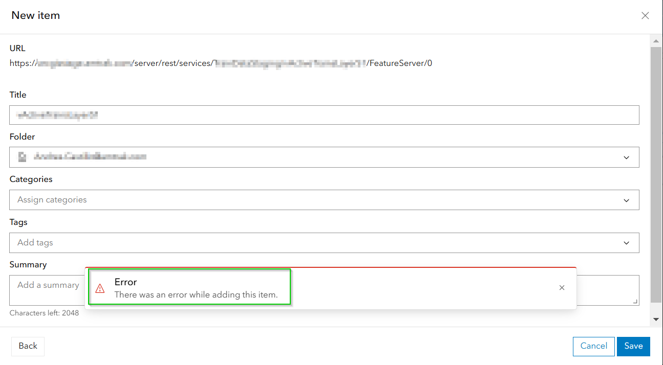

Since User 2 owns the FL in Portal A, embed those credentials
In ArcGIS Enterprise Portal, you get this error:
Error
There was an error while adding this item.

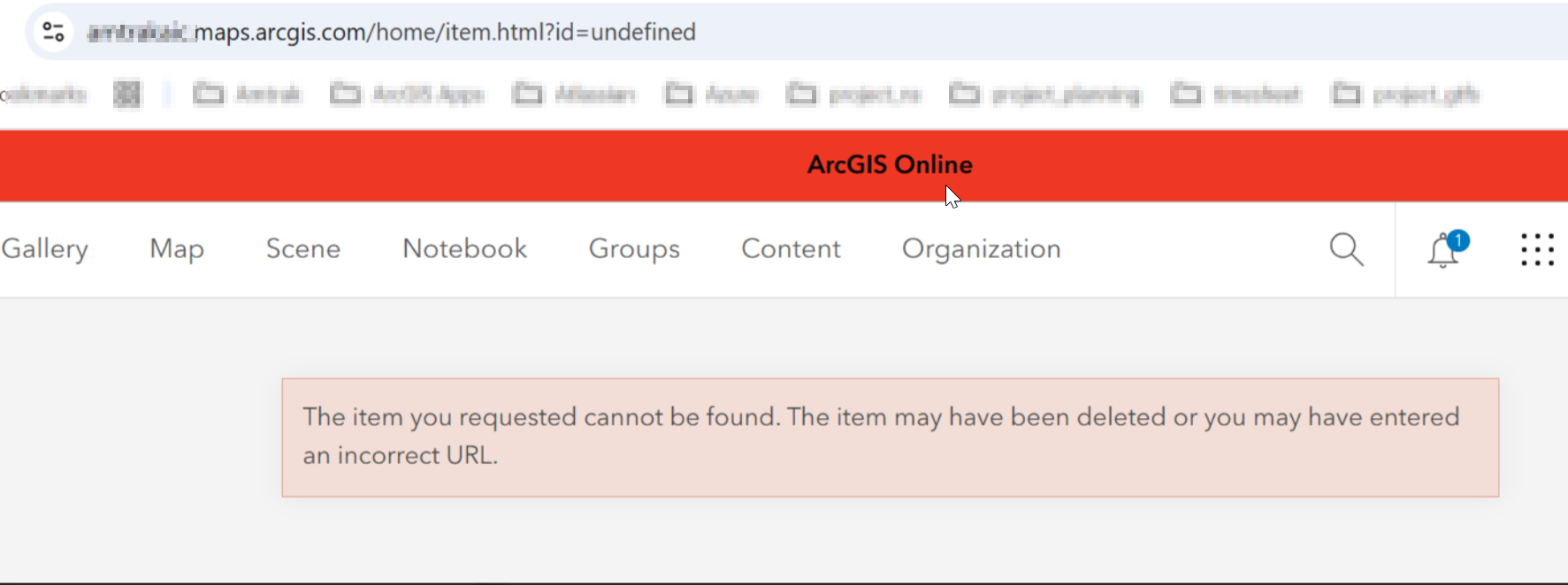

In ArcGIS Online, you get this error:
the page redirects to org.maps.arcgis.com/home/item.html?id=undefined
The item you requested cannot be found. The item may have been deleted or you may have entered an incorrect URL
These errors are fixed once the Map Image Layer owner is the same as the credentials you are embedding when adding the FeatureService url link.
In this case:
We are attempting to add Feature Service url (owned by user 2) using user 2 credentials.
But since the MIL is still owned by user 1, it fails.
Embedding user 1 credentials with the Feature Service url will fix it.

  • You can also choose to not embed credentials when adding the url link, but then you'd be prompted for credentials each time the layer loads onto an app the first time.
