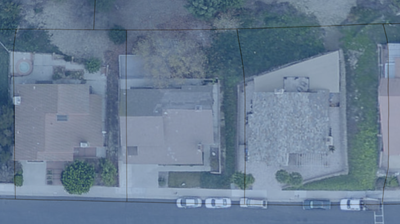

The black lines in this image should be straight. It appears the lines are following a 3d model of the ground. Is there a way to convert this to 2d so that the lines are straight?
Thank you!

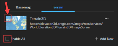

Another way to turn the elevation off is to disable all your sources of Terrain :

Found this under 'Environmental Effects'.
Thanks a million!
