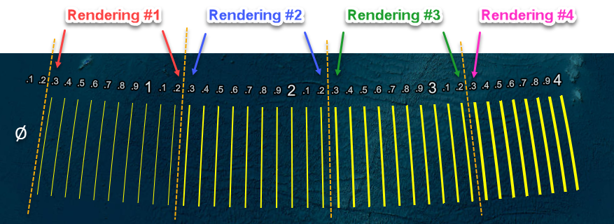

Hello,
I was wondering why the drawing tools would only let users choose integers – from 1 to 100 – for line width. After all, line width in KML is a float. I did some tests and found out that the rendering of lines is done by groups:
  • 0 – 0.24999997 → no rendering at all
  • 0.24999998 – 1.2499998 → rendering #1
  • 1.2499999 – 1.2499998 → rendering #2
  • 1.2499999 – 2.2499997 → rendering #3
  • 2.2499998 – 3.2499998 → rendering #4
  • and so on...
In my own opinion, any line that has a width above zero should be drawn. It should be:
  • 0 → no rendering at all
  • 0.0000001 – 1.2499998 → rendering #1
  • and so on...
Thank you !
P.S. : The KMZ I worked with is in the ZIP. You can see that the 0.1 and 0.2 width lines are not drawn.

Hi @GeoffroyRicher-Lalonde ,
Thank you for your valuable feedback and the data you've shared.
We've accurately identified the issue and plan to address it in the future release. We'll keep you updated promptly with any new developments. Your input is greatly appreciated!
