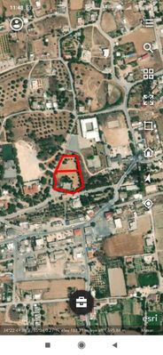

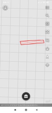

Hi, I am using Arcgis Earth Android latest version. I am adding data via arcgis server. Everything works. But when I try to identify layer, I can't get any results. The blue arrow appears on the screen and disappears.

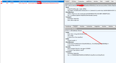

Hello, thanks for the solutions. I was trying to fix the problem yesterday. I removed the basemap and the 3dterrain layer. I just experimented with my layer, same result. Then I decided to examine the network traffic. When I try to define a layer, the request I send gives a 504 Timed Out error after a while. II don't understand why I can't identify. However, I can identify in the desktop application without any problems. How can i share my layer with you ?

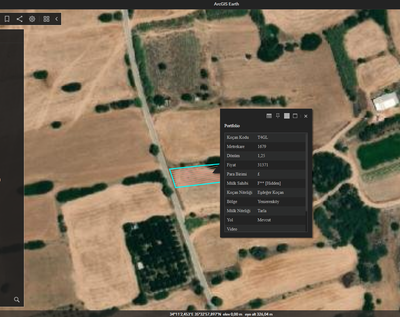

same layer in the desktop arcgis earth 
