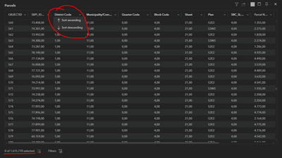

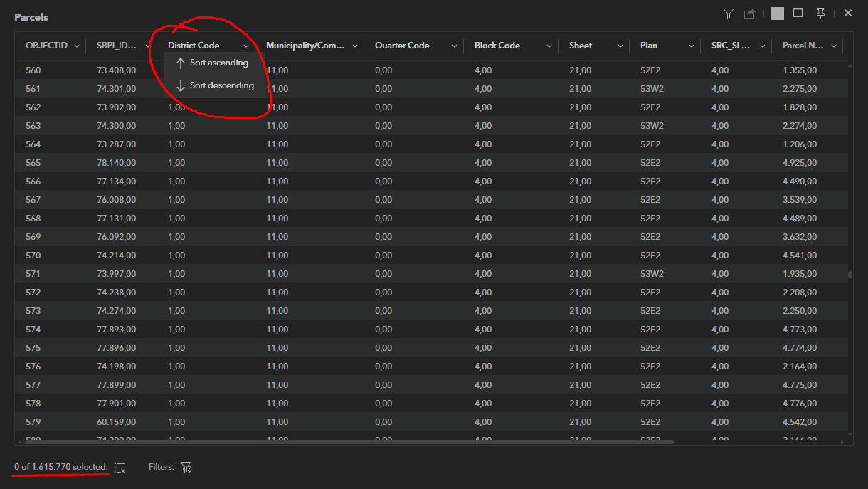

Hello, there are more than 1.5 million data registered in the database. I'm viewing them through Arcgis Earth, but the filtering features are very poor. The attributes table has only ascending-descending filtering. Is there an advanced filter feature for Arcgis Earh?

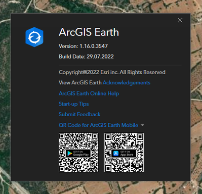

hi, im using version of 1.16.0.3547. however, there is no other option other than ascending-descending in the filtering options. can you help me please?

EmrahAydemir
I solved the problem. my layers support the "query" feature. but when I add it as a map service (/service/MapServer), the "filter" button does not appear. When I add it as a layer (/service/MapServer/0/query) the "filter" button appears. I will need to add separate layer for filter and map service to Arcgis Earth.
