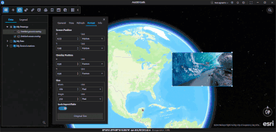

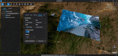

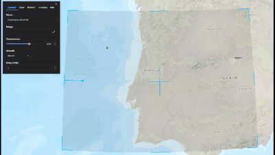

Hi @GeoffroyRicher-Lalonde , did you have a chance to try the aspect ratio enhancement in V2.3?
I've attached the following screen recording for quick reference:
Hello @Sharon_MU , the Lock Aspect Ratio enhancement is really great, thank you! It will facilitate the creation of Ground and Screen Overlays 😊

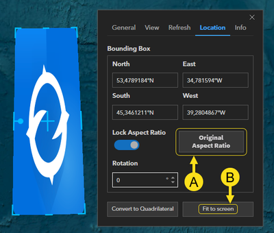

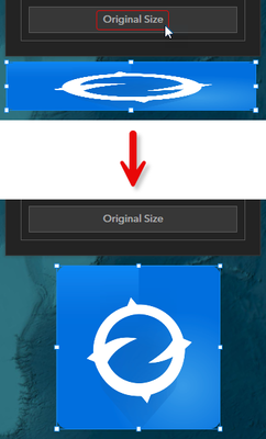

The only part that is still missing – from my personal point of view, of course – is a way to bring back the original aspect ratio of an image for a Ground Overlay. A user can bring back the original aspect ratio of an image for a Screen Overlay by using the Original Size button :
The addition of an Original Aspect Ratio button (A) would be useful for Ground Overlays. Another possibility could be to modify the behaviour of the existing Fit to screen button (B) so that it fills the screen and conserve the original aspect ratio (like in Google Earth Pro) :

Thanks @GeoffroyRicher-Lalonde for the prompt feedback and great sharing! 👍
I logged it for the internal review of our team. This function "Original Size/Aspect Ration" of Ground Overlay was not yet included in Ground Overlay for some consideration previously.
Just to share with you for your reference.  Images draped on the ground can be extremely reshaped especially when the terrain is complex or the altitude is high in 3D scene or globe surface. Even the image keeps the original aspect ratio, we're not sure if it still helps in actual cases.
Anyway, I've take down your idea for further research.  please stay tuned.
