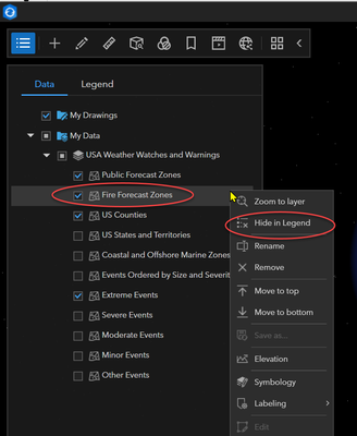

Could you try to hide the legend in the table of content panel ?   This may be a good workaround to help you show desired layers only.
The legend in Export window mirrors to that in Table of Content window.   If you hide it in the Legend window by the right-click context menu,  the corresponding legend item is removed from the whole legend page.
