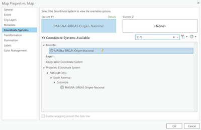

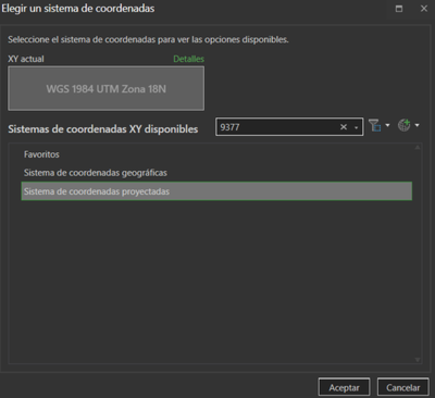

I have realized that Drone2Map is not recognizing the wkid 9377, while ArcGIS Pro does it. However, I've created a new projected coordinate system in Drone2Map with the parameters related (9377) and the products are generated under UTM Zone 18N.
Drone2Map coordinate system:
ArcGIS Pro:
