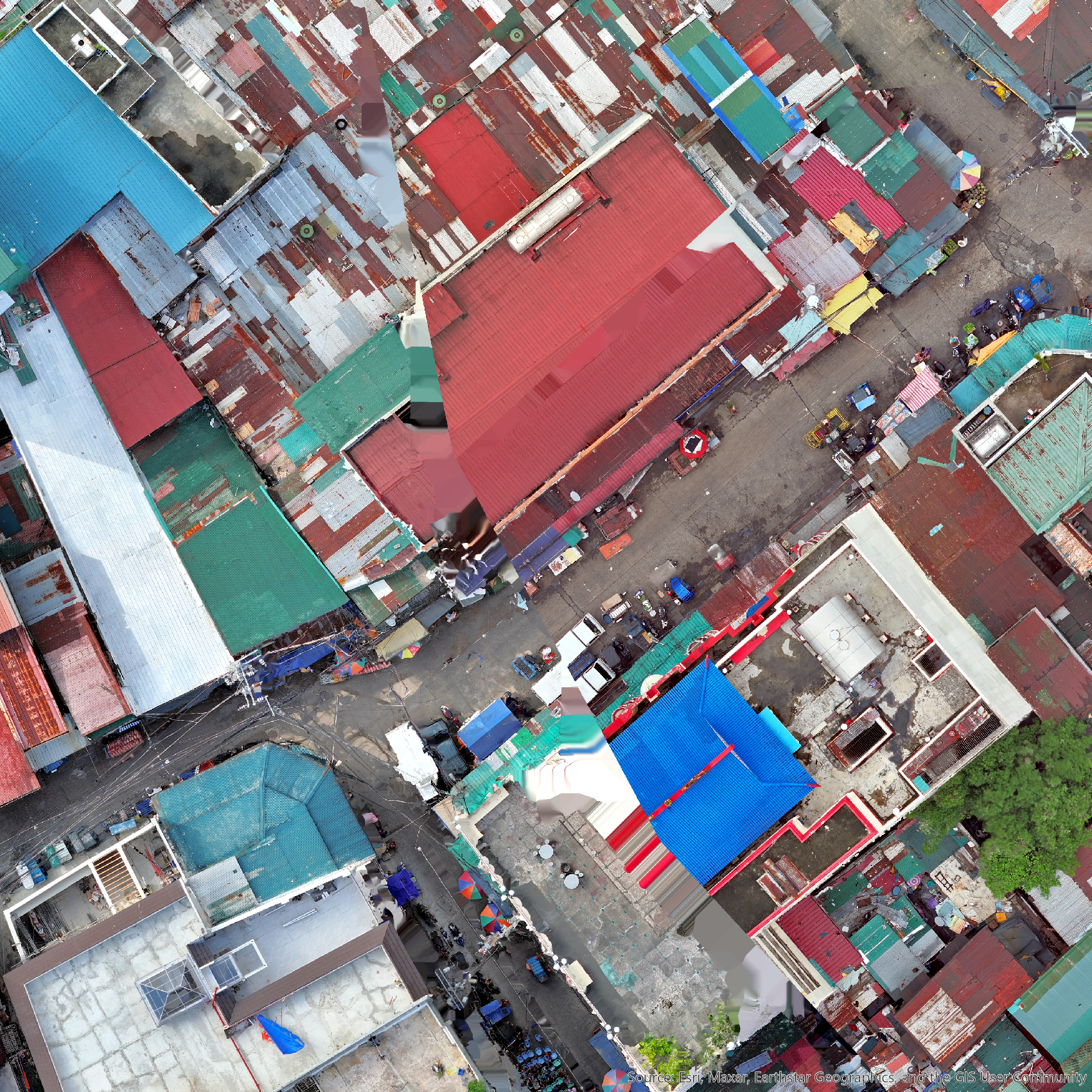

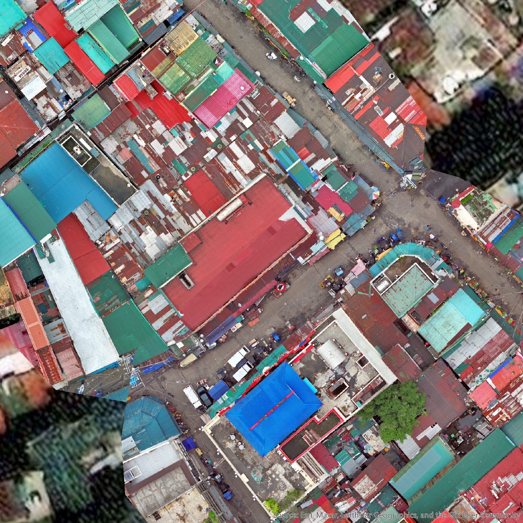

I produced a multiple true ortho images but when I try to stich or combined the images, the overlapping is not aligned with each other, what's the best solution to align and stitch it?
kindly see the attached file for reference.

Through ArcGIS Pro, I used drone2map to process multiple flight of my drone images, then I want to stitch all the true ortho images that I produced in ArcGIS Pro.

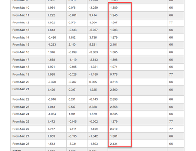

Thank you for sharing the processing reports. It looks like you used a lot of GCPs created from the map and many of them are displaying high projection error. Have you processed the imagery without GCPs and still had issues mosaicking the results together?

I wanted to confirm that you are selecting all of your ground control points on the ground?  If you are surveying your own points with GPS, you can use control on tops of buildings - but when extracting control from the map note that the Z value comes from Esri's World Terrain which provides an estimate of the ground height, not including buildings.
