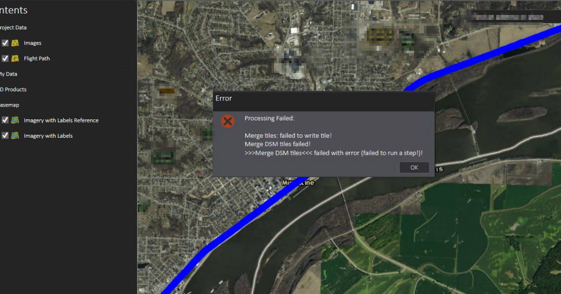

Nothing more exciting that waiting 2 days for Drone2Map to Crash on 3041 raw images.
Re-run and it hangs on hour 40+ with no logs. Had noticed Drone2map had several instances of itself running.
Try a different area with under a 1000 tiles and now get this:  (at72% complete)
I have the logs at Info and there is nothing in them other than what is also seen in the Error dialog.

I can pick 50 images, it works. gets to 100% and have a complete output
I try 250 Images, it works, gets to 100% and have a complete output
I add 900 images.. it fails
I add 501 images, it fails.  72%

I have also discovered that one batch of 999 images had one corrupt image, which Drone2Map does not let the user know...
