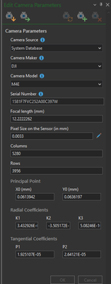

Are multiple camera models being detected within the Edit Camera pane? (Flight Data tab> Edit Camera)
Also, do you remember if you changed any settings between flights?
If you could share a screenshot/s of the edit camera pane, depending on if multiple models are appearing.

I can only see one camera in my project. I didn't change anything between flights, but I did accidently bump the gimble control and it changed the angel of the camera for a few photos. I attached a few screenshots, and also attached the processing report.

So I do get result folders but they are usually empty. One thing it does produce is a csv file with the image metadata. After looking at that it did appear that I had images with different focal lengths. I removed the images with different focal lengths and it is producing the true ortho.
So my best guess is that I bumped the zoom trigger and it changed a setting that caused it to fail. I will have to fun it on a smaller area and then stitch them together.
