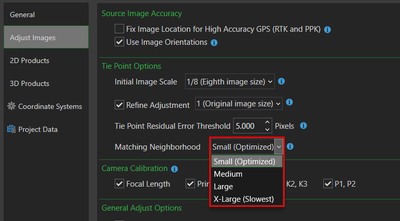

As others have pointed out, it is difficult to perform a proper block adjustment of the images when those images mostly consist of water. Drone2Map and other photogrammetry software try to look for key points between flight images. However, wind and light can significantly change the surface of water between each image and makes finding those key points very complicated.
You could try to increase the matching neighborhood of the images through the processing options window.
Changing this option would allow for a larger sample of images during the tie point generation process and potentially lead to more image matches/calibrations. This would still only really help though if there were enough land features present within the imagery.
Feel free to share the processing report from the project and I would be happy to review it.
