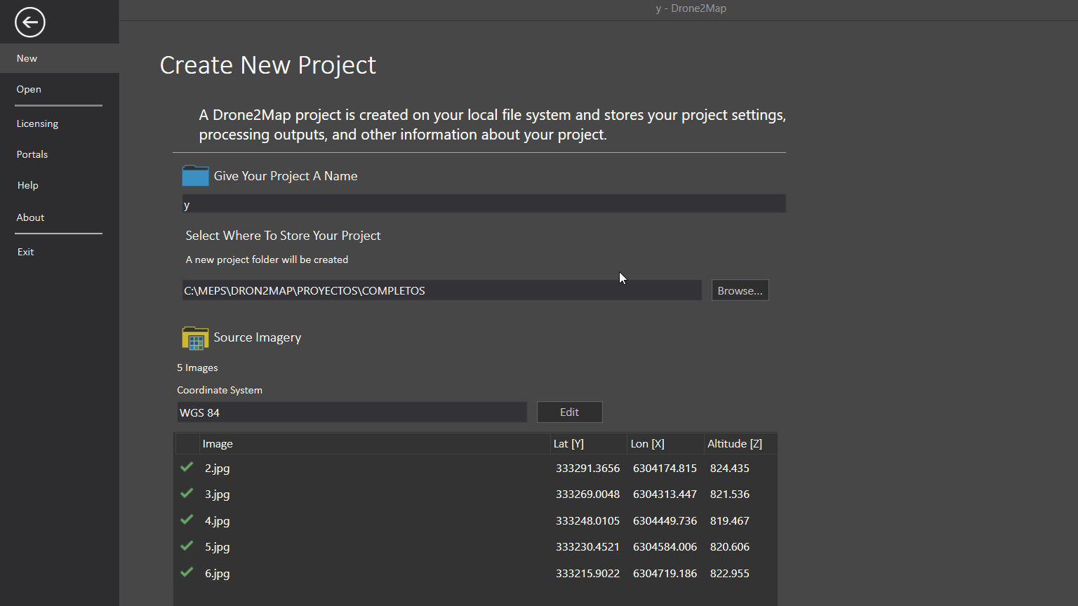

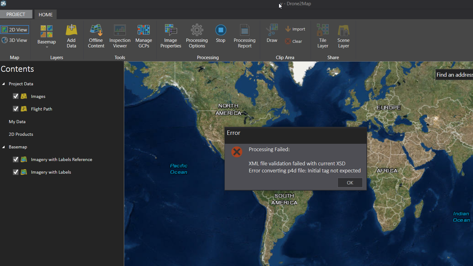

Hola,
Estoy utilizando DRONE2MAP y tengo el error. Leo los datos in problema.
Se agradece la ayuda.
Maria

are you sure your coordinates are GCS WGS84?  The values listed seem to reflect a projected coordinate system
Maria_ElenaPezoa
Hi,... I am using WGS84, UTM ZONE 19 S......
DanPatterson_Retired
MVP Emeritus
Ok... the coordinate system must have been truncated, the values are appropriate then, so that can be ruled out.
AnthonyMason
Maria,
Does your imagery contain Yaw, Pitch and Roll data? There is a known issue with imagery containing this information that will be fixed in an update being released next week.
Thanks
