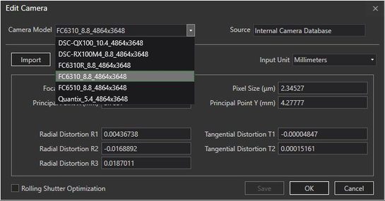

Here are two screen shots from Drone2Map's camera settings.  The second image I attached shows the camera models in the program's internal camera database.  I believe Drone2Map is built off of the Pix4D mapping engine. You may want to check out Pix4D support documents to see if they say anything about using the Mavic.  There are discussions within the drone mapping community regarding the Mavic's rolling shutter camera causing mapping issues.  It looks like the camera settings has the rolling shutter optimization option to fix the rolling shutter issue.  Just more things to think about...
