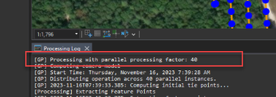

I am currently using 2023.1 on an Enterprise 11.1 system and I am learning how to use the software. I have tried following ESRI training course but I have ran into an Error 999999 each time I try to run the process. Most recently I attempted the training here https://learn.arcgis.com/en/projects/get-started-with-arcgis-drone2map/ and I have downloaded the data for the project. However When ever I start running the process it always fails. Here is what the process log looks like:
 Any suggestions on what I should do differently?

Hi @BrandonMcAlister ,
Looking at the screenshot that you shared it appears that the 40 threads are still in use.
Would you mind sharing the project log to confirm?
I can ask around to see if we potentially have a dual CPU machine to test with. I have a suspicion that might be the issue here considering the thread count setting in the options doesn't seem like its being honored for your setup.
If you have the time to test the dataset on the new computer to help confirm this further I would appreciate it.

BrandonMcAlister
HI @MarkBarker1
I was able to get my new computer set up this week and ran the same dataset of 48 threads and it successfully ran. I used the exact same default settings as I was using on the old computer. Do you still want the project log from the old PC? If so where is it saved?

BrandonMcAlister
Hey @MarkBarker1
I discovered something today on my new PC, the SLI was not activated on the new PC and once I set it up I started receiving the same error again. SLI was not active on the old PC either.

MarkBarker1
Hi @BrandonMcAlister,
Thank you for the logs and the additional testing you ran through. An SLI configuration is not something we officially support yet in Drone2Map or other ArcGIS software (Pro), which would be why you are hitting some odd errors. We are open to exploring adding in some type of support in the future if it has enough interest. If you would like to see it added, please post on our ArcGIS Drone2Map ideas forum.
