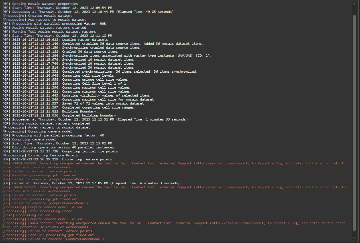

Hey Everyone,

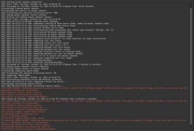

I am currently using 2023.1 on an Enterprise 11.1 system and I am learning how to use the software. I have tried following ESRI training course but I have ran into an Error 999999 each time I try to run the process. Most recently I attempted the training here https://learn.arcgis.com/en/projects/get-started-with-arcgis-drone2map/ and I have downloaded the data for the project. However When ever I start running the process it always fails. Here is what the process log looks like:
 Any suggestions on what I should do differently?

Hi @BrandonMcAlister,

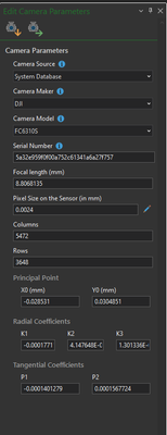

Based off the error log that you posted it looks like processing is failing at the compute camera model step. Can you post a screenshot of the camera parameters that are being used. This can be found by going to the Flight Data tab> Edit Camera>Edit Camera Pane.

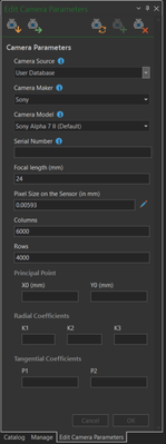

When I made this post we had a work around procedure where we brought the photos into Adobe Lightroom and exported them from there, this would cause the image to lose its metadata and we had to define the camera model. However our specific camera model was not listed in Drone2Map. Below is the user setting I created for the Camera model, this was used during the test shown above.

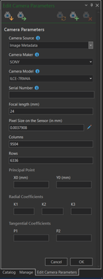

Yesterday I updated the software to 2023.2 Build 188405, our images now have metadata and the camera settings are different from when I ran it originally. See below, I find it odd that the Camera Model is not what we have.

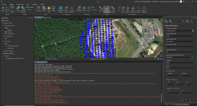

It failed at the same step, below is the full screen
Thanks,
Brandon
MarkBarker1
Looking at your screenshots that you shared it appears you are running with a really high thread count during processing. We previously had an issue with going over 20 threads in Drone2Map 2023.1, but it should have been rectified with the latest 2023.2 version. However, based off what you are showing that might not fully be the case.

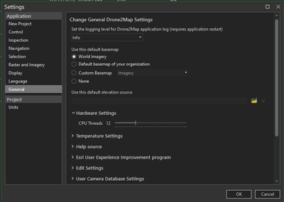

If you attempt to manually lower the thread count to say 12 or so does the processing complete (Options> General> Hardware). If not, are you able to provide a bit more information on the machine you are working on? Specifically the hardware in use and whether or not it's a VM.

BrandonMcAlister
Hi @MarkBarker1
I ran the test again this morning and after lowering my CPU thread from 40 down to 12:
and here is the full screen after it failed
The PC hardware is as follows
