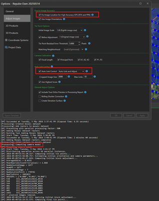

Hi @MarkBarker1, I was wondering if the Auto Link and Adjust is able to run if the source imagery is using High Accuracy Position? I need to test more but it looks like the Detecting Control stage hasn't run after the Computing Camera Model log entry.
MarkBarker1
Hi @JamesHead-Mears1,
Thanks for reporting the behavior. I ran through some testing on my end with both imported GCPs and GCPs created from the map and couldn't reproduce it in Drone2Map 2026.1. Are you able to provide me with your processing report and if possible the flight and GCP data?
We do allow for the detection process to run even if you are using the fix image to high accuracy option. Realistically, it wouldn't be something you would want to do though with RTK data as you would typically be using check points and not adjusting to GCPs since your RTK images would be assumed accurate. However, there are cases where that might not be the case, such as poor accuracy collection during the flight by the drone so that's why we do still make it available.
Regards,
