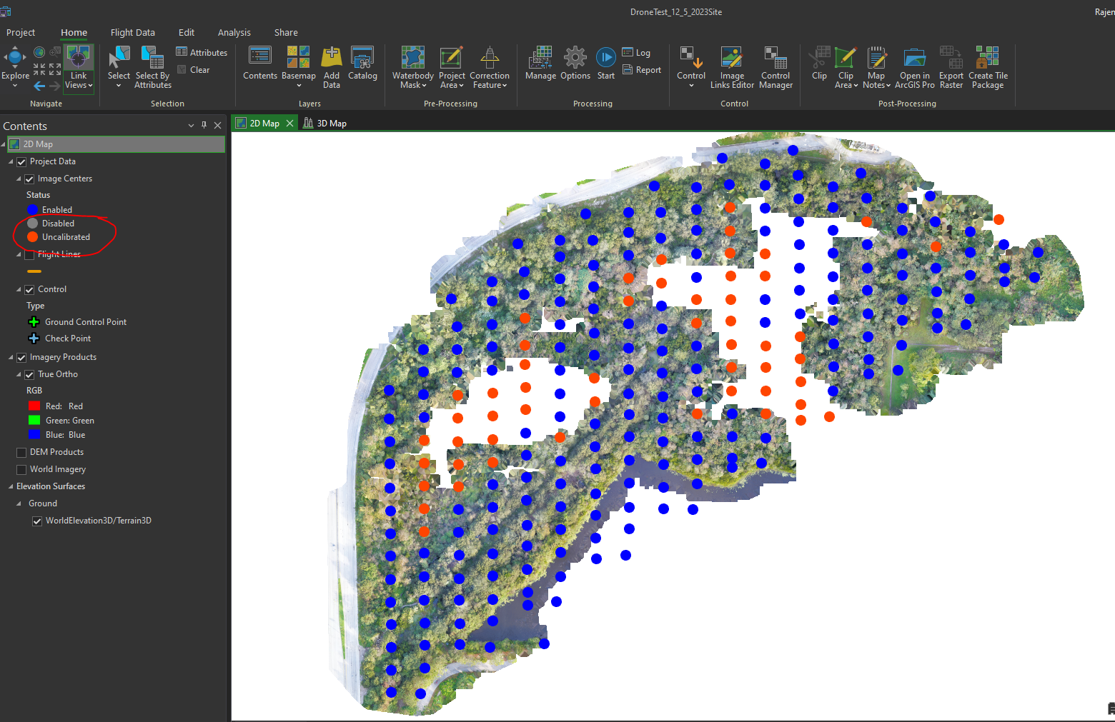

Hello
While processing my drone images to prepare an orthomosaic, I am getting several Uncalibrated image centers as shown in the image below, red dots, which is resulting in an incomplete orthomosaic as shown in the background. I have tried several different options for processing including varying Tie Point Options - Initial Image Scale/Refine Adjustment/Matching Neighborhood. Each provided different numbers of uncalibrated points but never a complete ortho image with no uncalibrated image centers. I also tried the fix image locations for high accuracy GPS but that also didn't work. Any suggestions would be appreciated - i am new to drones and the D2M software.
We were able to get a complete ortho with another drone image processing software so i am assuming this has to do something with the processing options selected?
Thank you

Hi @RajendraSishodia ,
Based off your testing already with the various processing options and still not finding any success I think it would be best if I got a copy of the imagery to test on my end. Please let me know if you are able to share it out and I can get a shared folder going. You can email me directly if you would prefer: mbarker@esri.com

Were you able to resolve the original contributors issue? I am having the exact same issue with one of my projects. I have made changes (many iterations with adjustments) to dense matching, project resolution, image orientation, all aspects of tie point options, and even camera calibration. The imagery was also processed with another cloud based software and produced a complete product. Any help or guidance is appreciated.

How do I share my project with you? I'm having the same issues as the original poster. I'm a high school teacher and my students and I are trying to figure this out.

You can reach out to me through the same email: mbarker@esri.com. I am happy to setup a folder to take a look at the dataset you are using and see if I can provide any recommendations. We are hoping to release Drone2Map 2025.2 this month and with it significant processing engine improvements that should cut down on instances of holes within the True Orthos.

Have seen troubles in forested areas with generating "true ortho' (ArcGIS Reality) vs more traditional ortho (which may be processed in ArcGIS Pro). Might be your.only option with D2M is 'more overlap' and/or combine vertical and oblique images. Looking forward to the findings of @MarkBarker1
