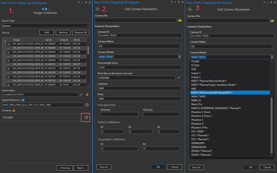

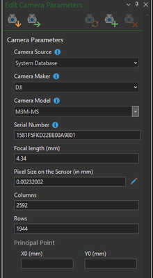

I just started taking drone images and processing them in ArcGIS Pro. According to the problem described by BrentDoty, I have similar questions. So, in my ArcGIS version, the DJI Mavic 3 Multispectral camera parameters did not show up. I filled them in manually, and I was able to create an orthomosaic by just using the RGB images :-).

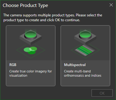

@BrentDoty @JonasTrenz There are two different camera models for the Mavic 3 Multispectral sensor, one for RGB and the other for Multispectral. In Drone2Map we have you select the type of product you want to create when first importing the imagery in the new project page. You will receive a pop-up (see below) that offers options based off the capabilities of the camera. This determines what camera model is used and the settings for the project.
@JonasTrenz In ArcGIS Pro the same concept applies but you need to manually change the camera model if you would like RGB or a Multispectral output. The camera models determine certain processing parameters as well as the band order.

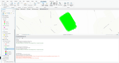

@MarkBarker1, thanks a lot for your support. I updated my ArcGis version, changed the camera settings, and imported the my file. After adjusting I wanted to create an orthomosaic but got this error message:
 Could you let me know if you're familiar with this problem?
MarkBarker1
@JonasTrenz I have not encountered that error before, but the messaging seems pretty specific. I would first recommend looking for the image with the OID it is mentioning and removing it, then trying processing again.
