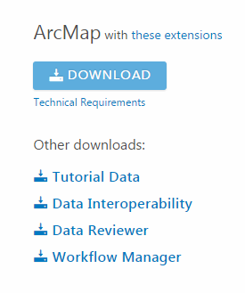

It does not appear that Data Interoperability is available to download from the trial. I have raised this with Esri.
AndySmith
Just as a follow up to this I raised this with the Esri design team. Data Interoperability, Workflow Manager and Data Reviewer have now been included as a separate download within the trial as a result. The downloads may be found under "Trial Downloads".
