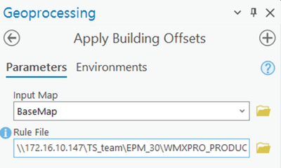

DanHopkins
Hi @hm_stella
Thank you for your reply.
The TM50_BuildingOffsets.xml rule file is to be used with the Apply Building Offsets tool.
The TM50_BridgeOffsets.xml rule file is to be used with the Calculate Bridge Offsets tool.
Can you please attach a screenshot of the values you are entering for the Apply Building Offsets tool?
Thanks,
Dan

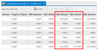

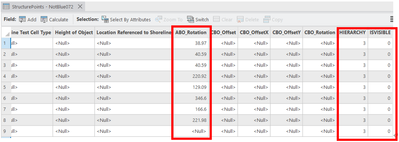

hm_stella
Hi @DanHopkins
Yes Sure! I actually used the tool for twice, each for building and bridge. I'll just attach both cases.
1) TM50_BridgeOffsets.xml
- TransportationGroundCurves
- TransportationGroundPoints
2) TM50_BuildingOffsets.xml
- StructurePoints
Based on your reply, TM50_BrdigeOffsets.xml rule file is for the Calculate Bridge Offsets tool isn't it?
But, I am kind of confused because the help document tells that I can use both bridge and building xml files for the Apply Building Offsets tool and I saw that all the parameters used for the Calculate Bridge Offsets like Input Bridge Features, Overpassing Features, Search Distance, and others were already specified in the xml file.
If I should have used the TM50_BridgeOffsets.xml file for the Calculate Bridge Offsets tool, does it mean that I have to re-clarify which parameters I use even though they are already in the file? IF so, should I put all the feature layers containing Bridge symbols as the Input Bridge Features in the tool?
Please let me know if the screenshots are not clear.
