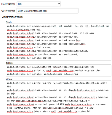

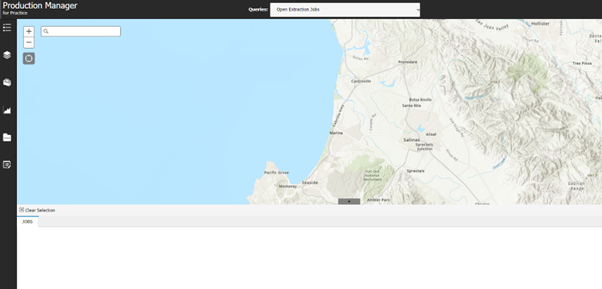

I could successfully open the production manager app, but got stuck in another error. It's the Job Query Settings!
I did follow what the deployment guide mentions, using fully qualified table names and editing the highlighted part to match my Task Group name. However, after that I came back to the app and clicked query drop-down lists I made, and there was not jobs table shown up. The jobs table (look like an attribute table) just stays at the bottom of the app, and the status charts shows nothing. The pie charts are all blank.

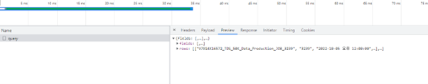

In this situation, I was trying to see if there are no results made for the queries. I checked directly in the PGAdmin since my workflow manager db is postgresql and also opened Chrome Developer's tool to see whether the query received the response.

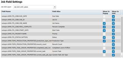

Since no fields appear in the table, it looks like your issue is in the Fields: portion of the query. Can you:
1. Confirm that below the queries, the Job Field Settings dialog shows all of the field names in the Job AOI layer? See below for my example:
2. If yes - some widgets are case-sensitive, so your queries need to match the fully qualified field names exactly as you see them in the Job Field Settings. This means if tables are uppercase but their field name is lowercase, they must be specified exactly that way in the query. In PostgreSQL in ArcGIS, the field names are all lowercase - but I see that in your query, you have some as uppercase. The app should error when you create the query and offer to auto correct...is that happening?
If after reviewing the query you still have issues, try a very simple query of just say JTX_JOBS.id just to see if you can get the table to populate at all. That will help confirm that it's a syntax issue.
If you can post results form the Developer Tools in Chrome, please post a higher resolution copy of the image - the last ones were a bit difficult to see. Thanks!

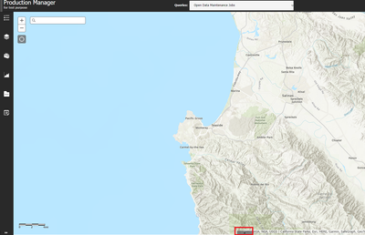

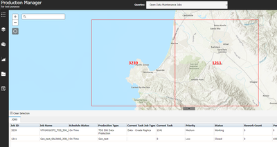

I did check whether my Job Field Settings and things looked appropriate. When I recheck the query as you mentioned, one by one, I found that the Job Query Settings could not load these fields: jtx_jobs.start_date and jtx_jobs.jtx_jobs.due_date. Every time I put them in the "Fields" box of Query Parameters, the production manager could not load the data into tables. When I removed them from the "Fields" box, the production manager successfully shows the data in table.
I attached some photos to give better understanding 🙂
1) When the fields do not contain jtx_jobs.start_date and jtx_jobs.jtx_jobs.due_date:
2) When the fields contain jtx_jobs.start_date and jtx_jobs.jtx_jobs.due_date:
I think those two fields are the primary reasons of this problem. But, I have to use those fields if I want to use the production manager properly, don't I? 🤔
