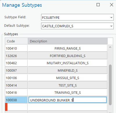

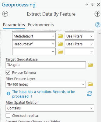

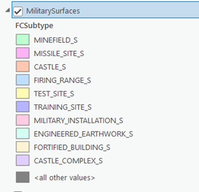

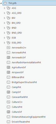

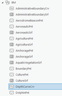

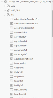

I wanted to maintain the DepthCurveCrv feature class and some feature subtypes of MilitarySurfaces feature class in TM geodatabase, as they used to be in TDS, even after running the GP tool.
So, like you said, I copied the DepthCurveCrv feature class from TDS_CARTO feature dataset to BM feature dataset of TM geodatabase, and created a feature subtype with the same defaults values of TDS into the MilitarySurface feature class.
The results, however, were not what I have expected. I ran the GP tool itself ouside of the workflow manager: all TDS&TDS_CARTO feature classes were extracted but not placed under BM feature dataset, and there were no DepthCurveCrv feature class at all.
When I ran the workflow (Cartogrpahy-Automated), I expected to have the DepthCurveCrv feature class and a new feature subtype of MilitarySurfce in the [JobName].gdb but no changes were made.
