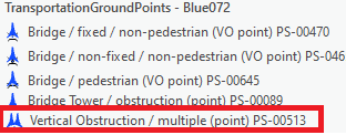

Hi,
I found that the symbology enables the features with Arcade expression ZI006_MEM == "multiple" to have Vertical Obstruction / multiple marker.

The thinning and symbolizing the multiple vertical obstructions is a manual process as of now. We are looking at adding a tool that would populate the multiple value and hide the other vertical obstructions based on a specified distance.
But for now you could select the vertical obstruction that you want to make as a multiple and calculate the ZI006_MEM value to "multiple" and calculate the ISVISIBLE attribute to 0. The other vertical obstructions you do not want to be symbolized calculate the ISVISIBLE attribute to 1. The definition query on the layer will only show the features that have the ISVISIBLE value set to 0.
So if you want to show any vertical obstructions then populate the ISVISIBLE = 0, if you want to hide any vertical obstructions populate the ISVISIBLE = 1. IF you want to show a vertical obstruction as multiple then you will need to populate ZI006_MEM = 'multiple" and ISVISIBLE = 0
