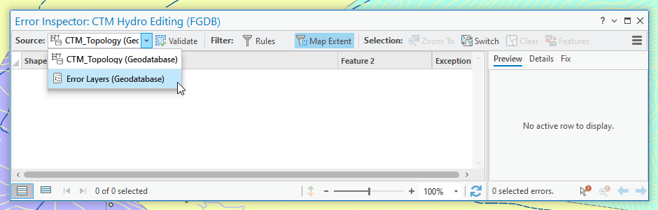

You should be able to use the Error Inspector to view both Topology rule and validation attribute rule errors (although the Error Inspector may default to displaying Topology rule errors).
To view attribute rule errors, you will need to ensure that you have added the error layers to the map. From the Error Inspector, select the Error Layers item from the Source drop-down menu. Here is a doc topic that walks through this process.

Thanks Jay. I am not sure what I was doing wrong before, but I am now able to switch the error inspector between topology and data reviewer error layers.
