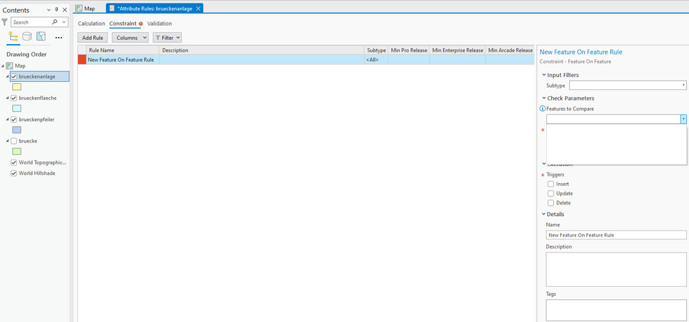

I want to create multiple Ready to Use Rules. However, as shown in the picture below, the required fields Features to Compare and Spatial Relationship are not possible to fill in. Same goes for all other Ready to Use Rules fields, where a value has to be selected from a pull down menu.
Is there anything I has to set up beforehand? Would be happy aboput any hints.

@DemouserDemouser I was able to reproduce the behaviour you are experiencing in a File Geodatabase. I may have found a solution. Use the Catalog pane to navigate to the File Geodatabase. Right-click the feature classes and go to Manage. Then enable Global IDs. Do this for all the necessary feature classes. After I did this, the feature classes would then appear in the Features to Compare dropdown list using the Ready to Use Rule you described.

Hello @JohnAnderson1 , many thanks for your help. However, it still doesn't work. I am using a FGDB and made sure all Feature Classes are within my FGDB. Still can't fill in the required fields. I also created new Feature Classes, but it is still not working.

It is working now! Thank you very much for your help and time. Any idea why global IDs need to be enabled?
