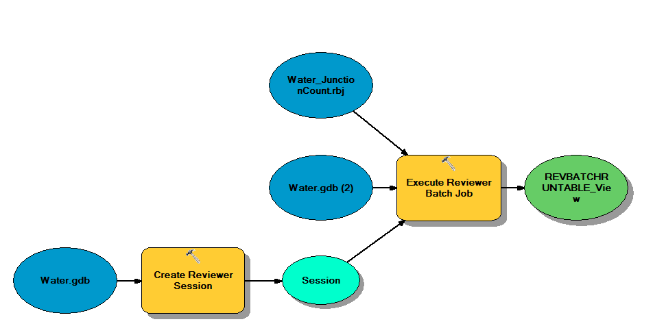

OK, I have created a model to give a total count for Water_OrphanJunctions in our water database. I have tested the model and the model sucessfully works and writes the results to the Reviewer Table(This is what I want). I then exported the model to Python and created a scheduled task within Windows Scheduler, the task runs and it's stated that it has run sucessfully but when I open the sessionin ArcMap I can select the newly created session but no records are written to the Reviewer Table. Has anyine experienced this problem or have a solution to fix this problem???
I have attached a pic of the model, I don't believe its the model but I AM TOTALLY LOST. Thanks againModel.png

Hi Jonah,
Please modify the session variable in exported python file as shown below:
Session = arcpy.CreateReviewerSession_Reviewer(Reviewer_workspace , "TestSession", "Session 1 : Session 1")

JonahWaterman
I'm really not familar with manipulating Python scripts, is there another simplified way or do you have a step by step workflow? Thanks a bunch and thank you for responding.
KumarBhardwaj
Deactivated User
Hi Jonah,
I have attached a video showing what you need to modify in the python script. I hope this helps.
Thanks,
Kumar
(view in My Videos)
JonahWaterman
Dude, you rock!!
