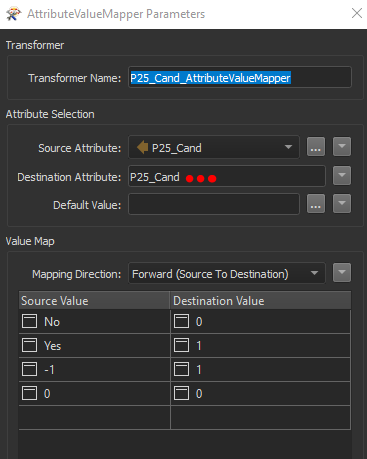

EDITBack in the office, trying to string a number of the AttributeValueMappers together and find that I cannot configure the newly changed value to map to the original field in the next AttributeValueMapper.  Can't attach the "_looked_up" field to the correct field in the next one.
red represents field I want to pass from first AttributeValueMapper to the next.red represents field I want to pass from first AttributeValueMapper to the next.
Can I just use the same field name in the Destination Attribute to string them together?
This does not seem right.
What am I missing?

BruceHarold
Esri Frequent Contributor
Adam you can chain two NullAttributeMapper transformers to do this, in one change 'Yes' to a new value 1 and in the other 'No' to 0.  Somewhat unhelpfully BulkAttributeMapper is an alias name for the transformer.

AdamRepsher
Thank you @BruceHarold !  I am finding that using FME for the first months is like when I started to use tools in ArcGIS Desktop.  I know what I want to do - but what does Esri call it???  🤣
Still strange why the reader is interpreting a field instead of just giving me a value.
