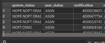

Probably something really obvious (sorry!), but I'm finding when publishing to Portal 10.8.1 using Data Interoperability, I have a string field containing all numbers. During publishing, a .0 is being appended to the end of each value during the publishing process. I've tried searching around on the FME forums but no luck so far.
Preview from workbench step just before the data is published:

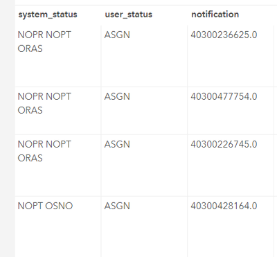

The result in Portal:

Update in case anybody else encounters this:
Many thanks to @BruceHarold who suggested the AttributeRounder, which worked despite the values not actually having decimal places in the data. The original cause I assume to be user error, as I configured a scaled down version of the workflow and did not encounter the issue again.

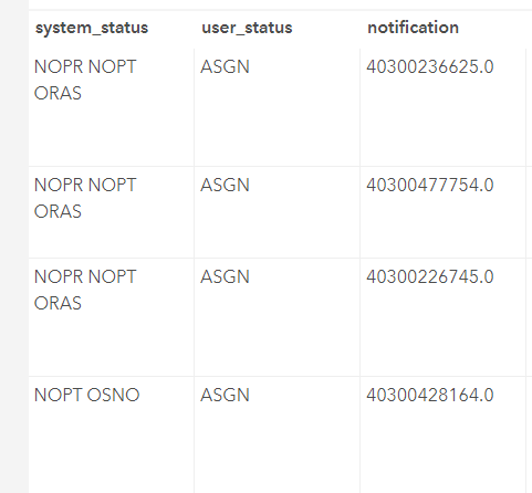

I also have some issues with the trailing .0 in string data for 2 or 3 days now. Every number gets a .0 added after the insert from FME. In my case, I don't use the suggested Transformer. Until this monday everything worked fine.

It's frustrating that something in FME or AGOL changes string data. A taling zero looks kind of weird for active Covid cases  ...

AttributeRounder changed nothing. Of course adding a space behind the value changed it and the the numbers appear without tailing zero. That's a neat little workarround, but I will recreate the feature layer today and test this new layer with the AttributeRounder, too.
