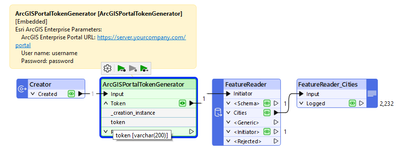

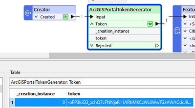

1. Add the token generator portion of your workspace. Creator + token generator transformer (like below).
2. Run the workflow to get a token on your translation log. Copy the tken frmo the Translation Log table

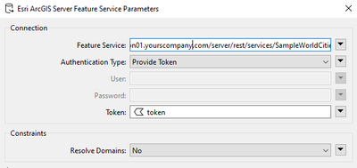

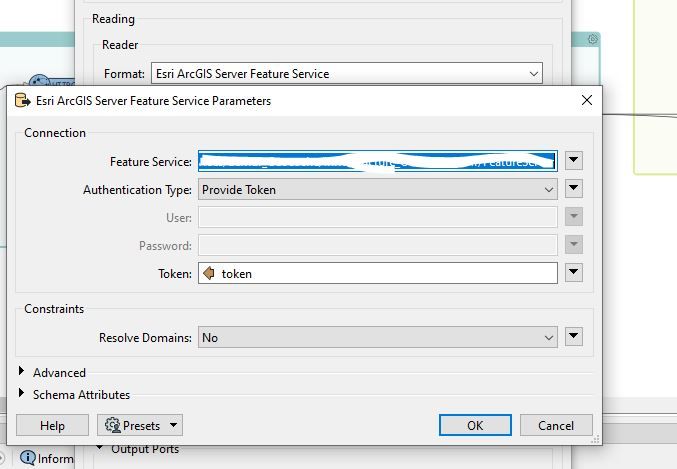

4. Configure the transformer for an ArcGIS Server Feature Service reader, like below.

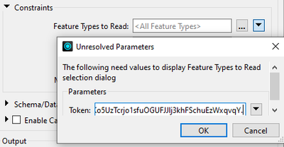

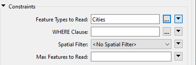

3. On the Constraints Tab --> Feature Typs to Read parameter, click on the ellipsis and you will be prompted with an Unresolved Parameters dialog to paste the token copied from Step 1 above.

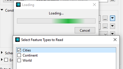

Click OK to open the Select Feature Layer to add options.
Pick one or more feature type/s, and click Ok and you would be prompted again to enter the token created from Step 1 above.
Once the token is added and Ok is clicked, the feature type/s selected will be added to the FeatureReader transformer with new output port/s. In this case it would be Cities

4. The whole workspace looks like below with a logger on the end.

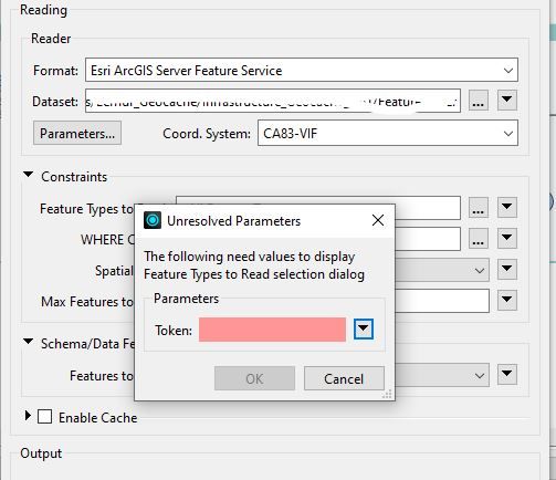

I'm generating a short-lived token (see figure 1), but the Feature Reader is requesting input of a token in the Constraints/Feature Types section in order to generate the subset of endpoints.  An error is thrown with the same token parameter.  Without the token, all endpoints are read.

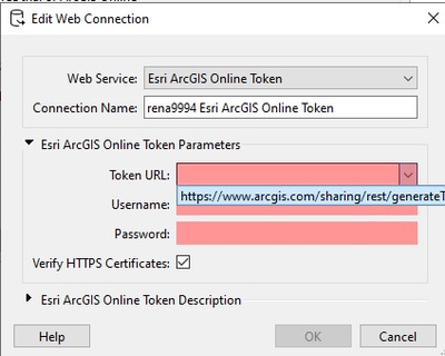

If you have plans to move up to Pro 3.5 and the DI extension, a new feature simplifies token generation by adding this option in the Edit Web Connection dialog of  the AGOL format reader/writer. There is a new option to configure your web connection, avoiding that nasty Unresolved parameter dialog by making it part of this new feature during authoring time.
