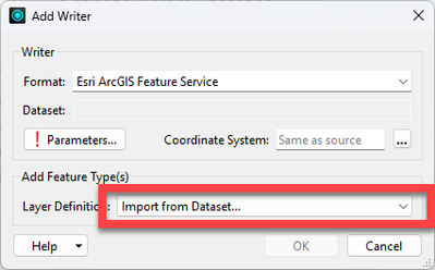

Per your suggestion, could you clarify exactly how to "define the writer by importing the schema from the source dataset" in FME? I'm not sure which dialog/step you mean (Add Writer vs. Import Feature Types vs. Feature Type Definition).

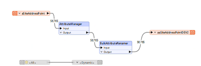

I've attached the log, and a screenshot of my workbench.

I’ve attached the log, and a screenshot of my workbench.

Hi June
When adding a writer you have the option to import its definition from an existing dataset, see outlined in red here:
