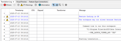

Customer description: when the workbench app is open and the user clicked on Run, the log stops on "Starting translation...".    Sometimes FME fails to load or stalls on the "Checking license" screen.

Scenario 1: Translation is frozen

Scenario 1: This is a known bug where fmeobjectworker.exe or fmeworkbench.exe are not released as in-memory processes during authoring-testing cycle and the translation is run by the author. It is likely the Feature Caching is enabled. The freeze is triggered after making changes in the canvas and translation is run to the transformer or feature type where the change is made.

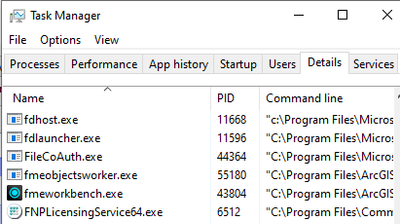

1. Go to Task Manager --> Details tab and click "End Process tree" on any or all instance of fmeworkerobject.exe until the translation log starts running.
2. Restarting the workbench app works most of the time, although, it's possible that the splash screen behavior may happen.  If this is the case, ending the fmeworkbench.exe from Task manager
