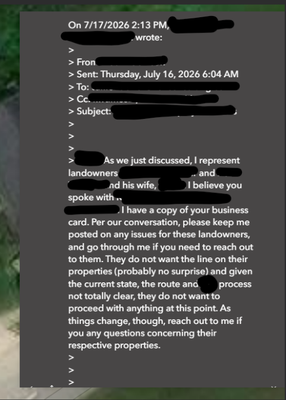

danieloccasionally
The process @BruceHarold described worked well for my ArcGIS Online Feature Service initially.
However, the text box generated was zoomed in so to speak with the top and bottom cut off. My screen and browser settings are not zoomed in or out so as to create this odd effect. And I tested a few different settings to ensure this was not on my side.
Had to zoom out (in my browser window) pretty far to see the whole note.
