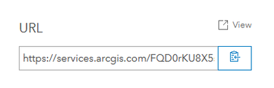

To do this, in your browser and logged in as the service owner, go to the Content section in the Home app and navigate to the feature service item.  At bottom right is a control that lets you View the item REST API:
Go there in your browser (your URL will of course be different).
