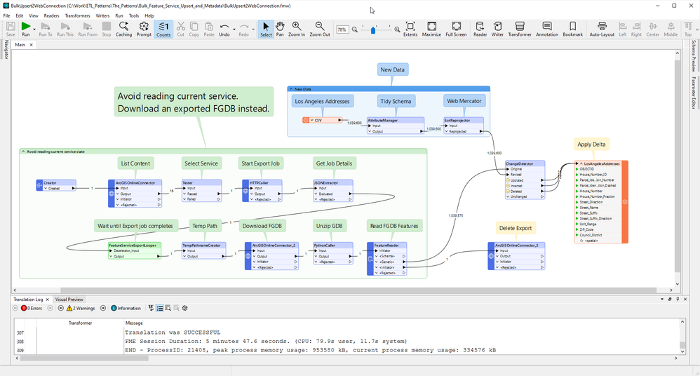

Using a web connection to drive changeUsing a web connection to drive change
The ETL workspace FMW source is in the post download.
There is no escaping retrieving new incoming data by download, but you can avoid streaming in the current state of the target feature service (which is comparatively slow) by asking the portal to generate a file geodatabase export, and downloading that.  The export job call requires a token, which is difficult to generate if your org is like mine and enforces multi-factor authentication (MFA).  The trick is to use web service authentication in the HTTPCaller transformers that initiate the export job and check job status in the custom looping transformer that waits for export job completion.  Web service authentication supplies a token behind the scenes so you don't have to supply it as an HTTP URL parameter. That is the central trick behind this approach.
You'll see from the workspace image above that a daily change transaction for Los Angeles' addresses is a tiny transaction at the end of a few minutes taken reading the data.  The log file (not shown) tells me 67 features took part in the transaction, which took 0.5s.
