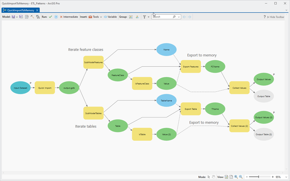

See below a simple model (in the Pro 3.4 toolbox in the blog download) that leverages the Quick Import system tool, delivered with ArcGIS Data Interoperability, which will read any of hundreds of formats of data supported by the extension, and any you have configured as custom formats, and write the data into the memory workspace for instant access in your Pro session.
QuickImportToMemoryQuickImportToMemory

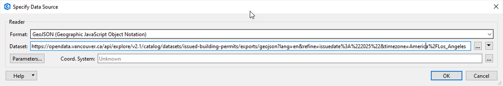

The processing is simple.  A Quick Import tool supports the data source input parameter, which lets you pick a format and source location.  What is saved in the tool is an example of GeoJSON at an API URL with filter parameters - building permits issued in Vancouver, BC to date in 2025:
Dataset input dialogDataset input dialog

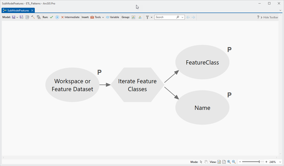

Quick Import creates an intermediate file geodatabase which submodels inspect for feature class and table outputs:

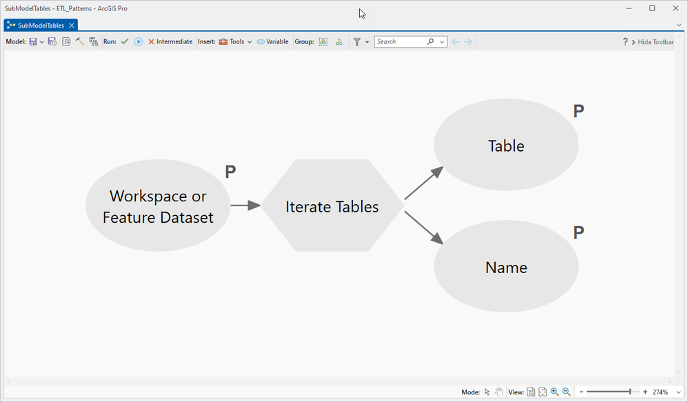

SubModelFeaturesSubModelFeaturesSubModelTablesSubModelTables
The found data object paths are returned to the parent model and exported to memory, then collected to be model output parameters.  The Collect Values model tool has the handy property that it suppresses visibility of output parameters so they don't clutter the model dialog when run as a tool.

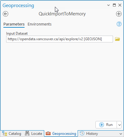

Tool dialog has only an input parameterTool dialog has only an input parameter
The intermediate file geodatabase is cleaned up when the data is in memory.

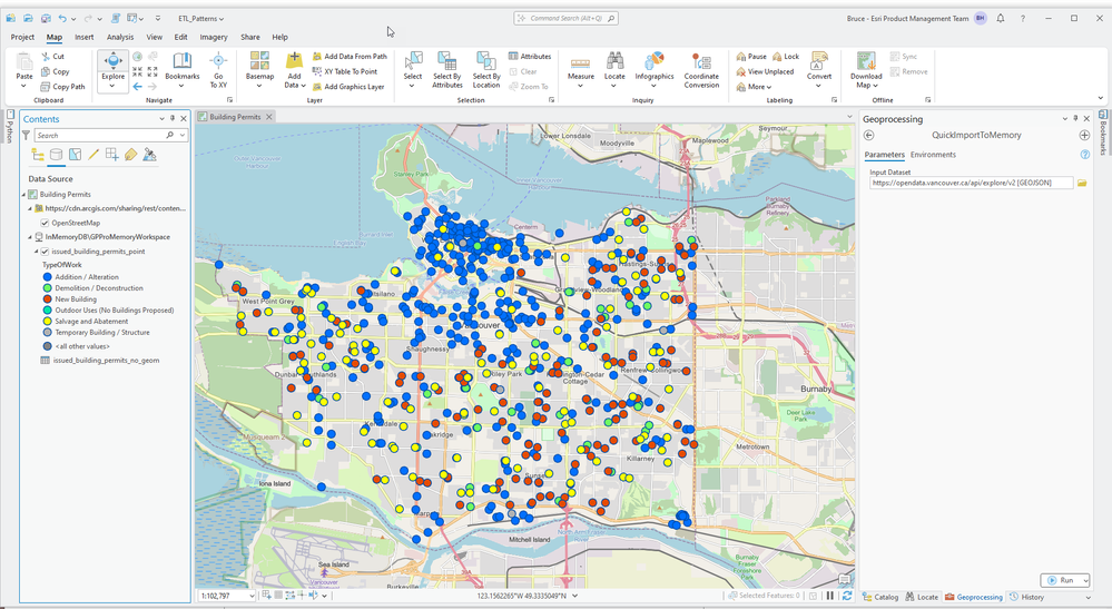

Features and table in memoryFeatures and table in memory
See in the Contents pane a feature class and table (a few GeoJSON features without geometry) were output by Quick Import and exported to memory.
