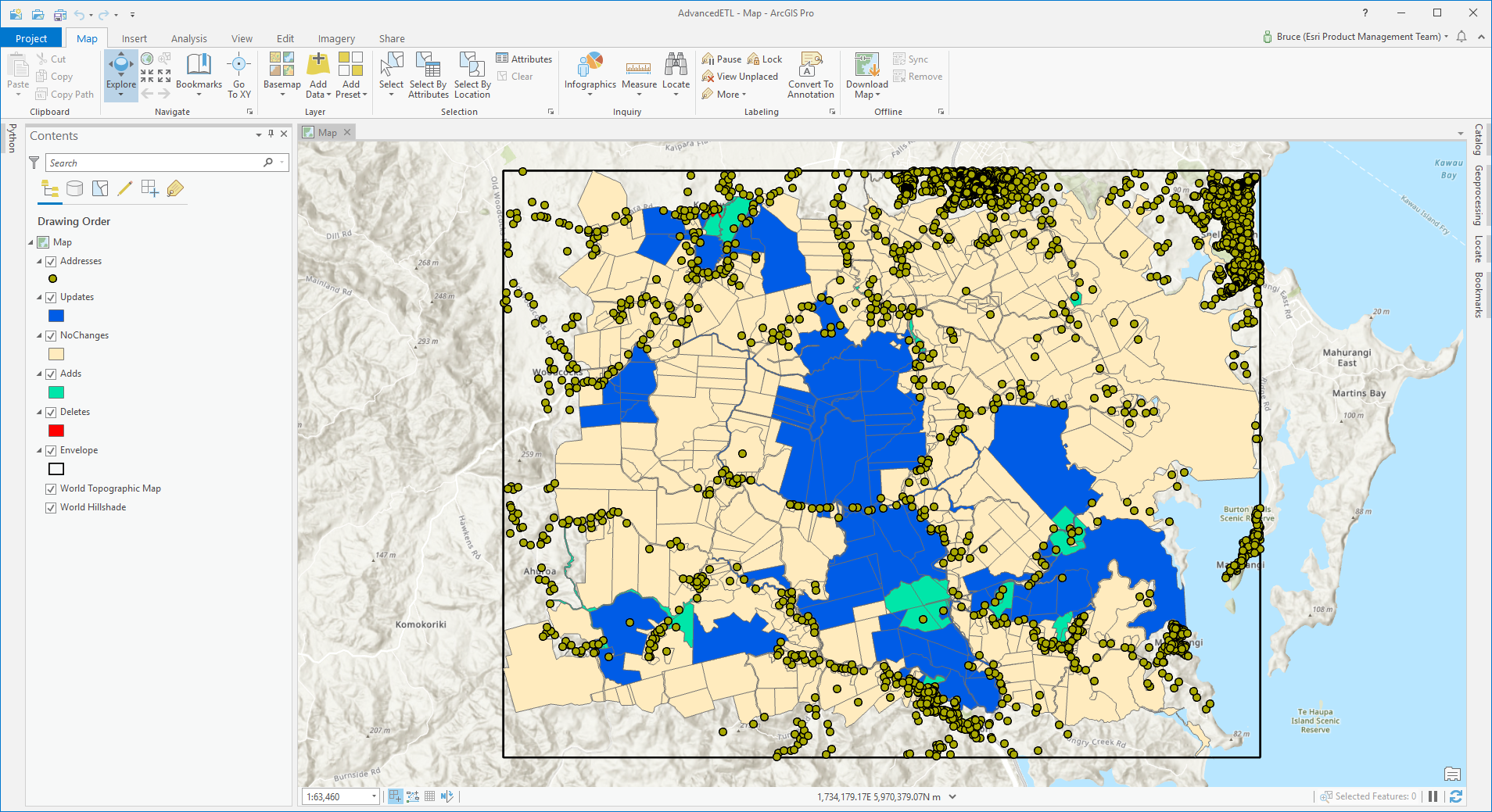

Here is some data:
In my project database it looks like this (the main point is it is all in one geodatabase):
...and my Project Toolbox has a Spatial ETL Tool and a Model:

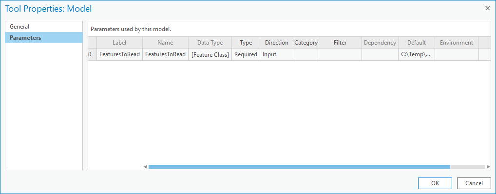

On the left is the sole input parameter 'FeaturesToRead', of type Feature Class (Multi Value) (you could use Feature Layer too with a little more work in the model to retrieve source dataset paths):

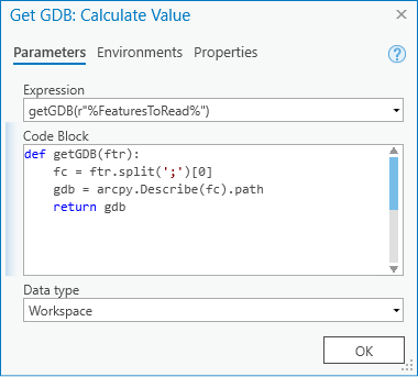

Get GDB:
This returns the Geodatabase of the first feature class in the input set.

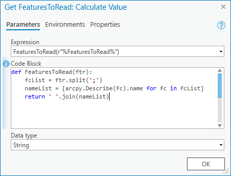

GetFeaturesToRead:
This returns the names of the feature classes as a space-separated string.
GetGDB and GetFeaturesToRead supply the ETL tool input parameter values.

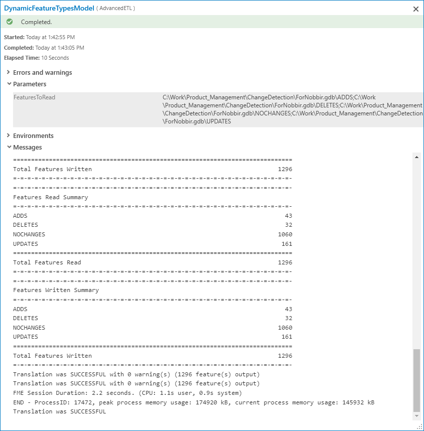

Here is the details view from a run with data from a different Geodatabase.
