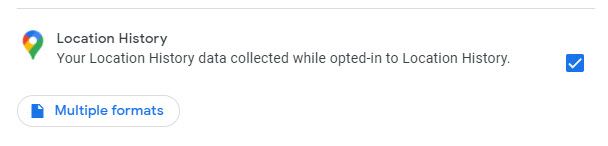

If you enable location history on your Android device you can download periodic snapshots of the location data, along with many other variables, from Google's Takeout site.  There are a lot of things you can package up in any download, if you're only interested in location data deselect all options and scroll about 2/3 the way through the options to find Location History, and select it:
Location HistoryLocation History

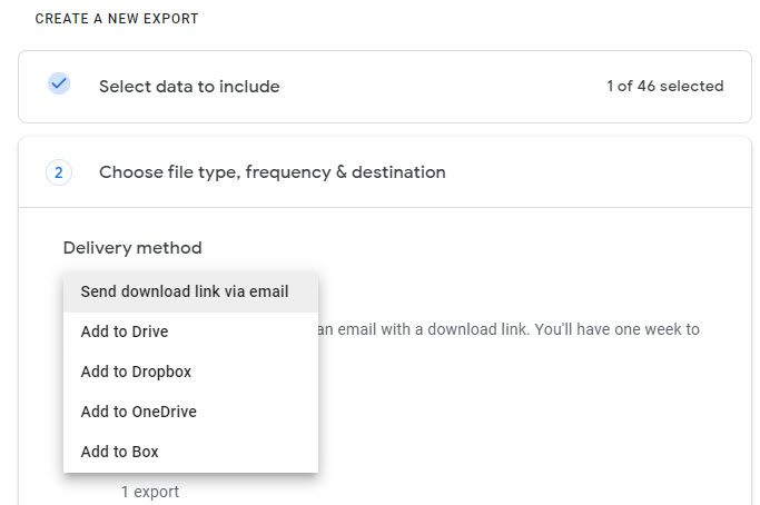

 While setting up your export there are some options to send the data to a cloud store, these are accessible to Data Interoperability too:
Export OptionsExport Options

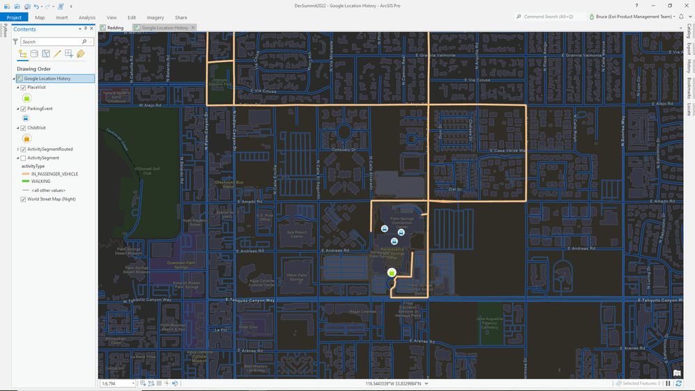

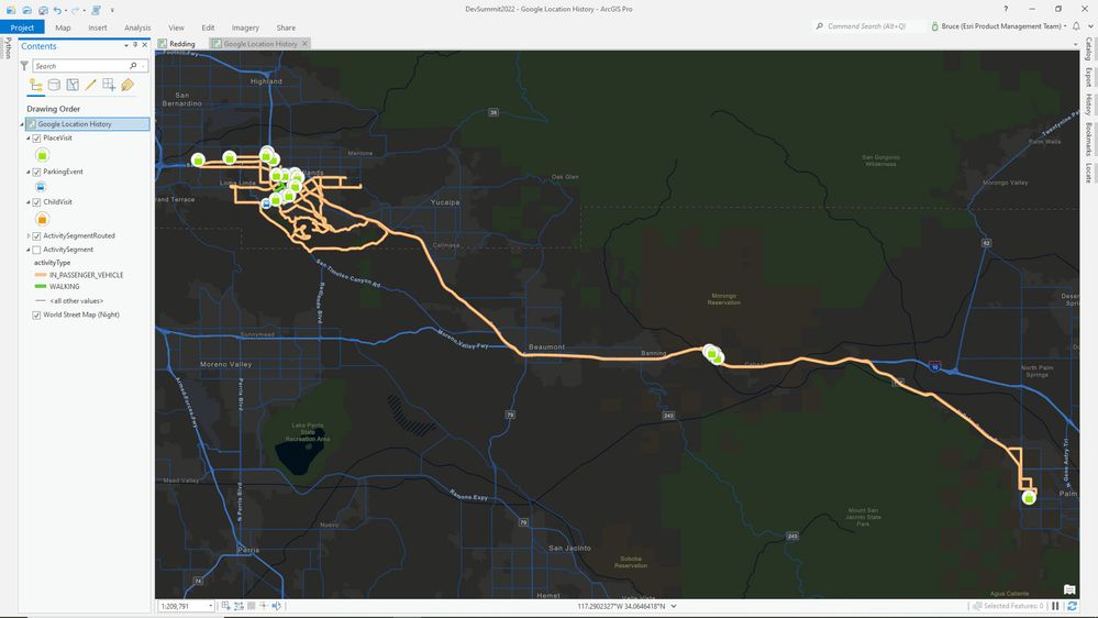

If we go back to the full extent we can see some activities in mid extent (shopping?) and in Palm Springs (working?).
Destination ActivitiesDestination Activities

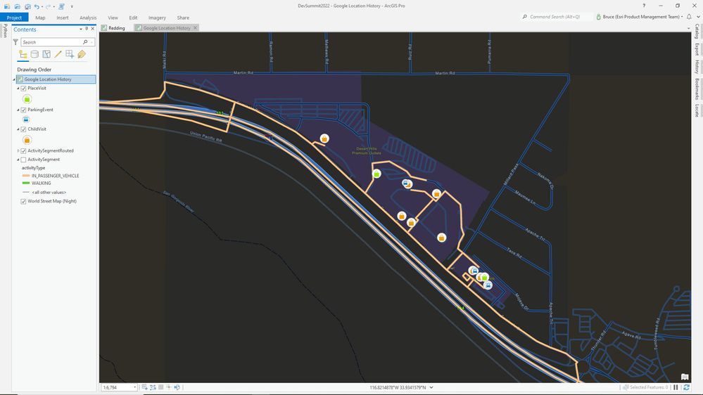

First the supposed shopping:
Desert Hills at CabazonDesert Hills at Cabazon
I can recommend the date shake at the place famous for them :-).
How about the final destination?
Palm Springs Convention CentrePalm Springs Convention Centre
The Esri conference!
