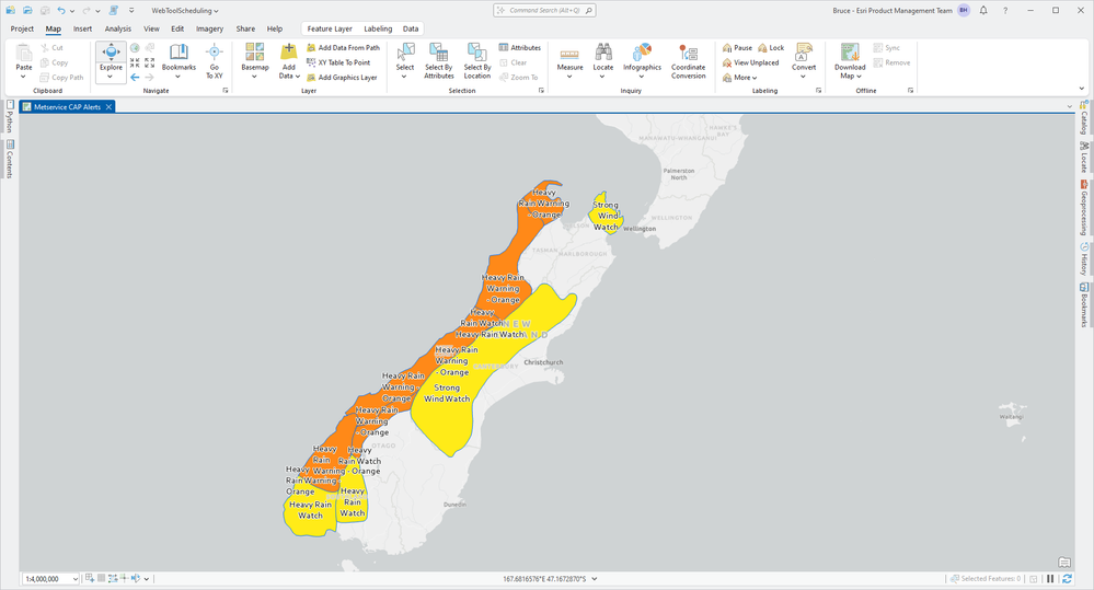

Below is a sample alert status map in ArcGIS Pro, for October 9th 2024.  The blog download has a couple of CAP alert XML documents, if you want to see some raw data.
CAP Weather AlertsCAP Weather Alerts

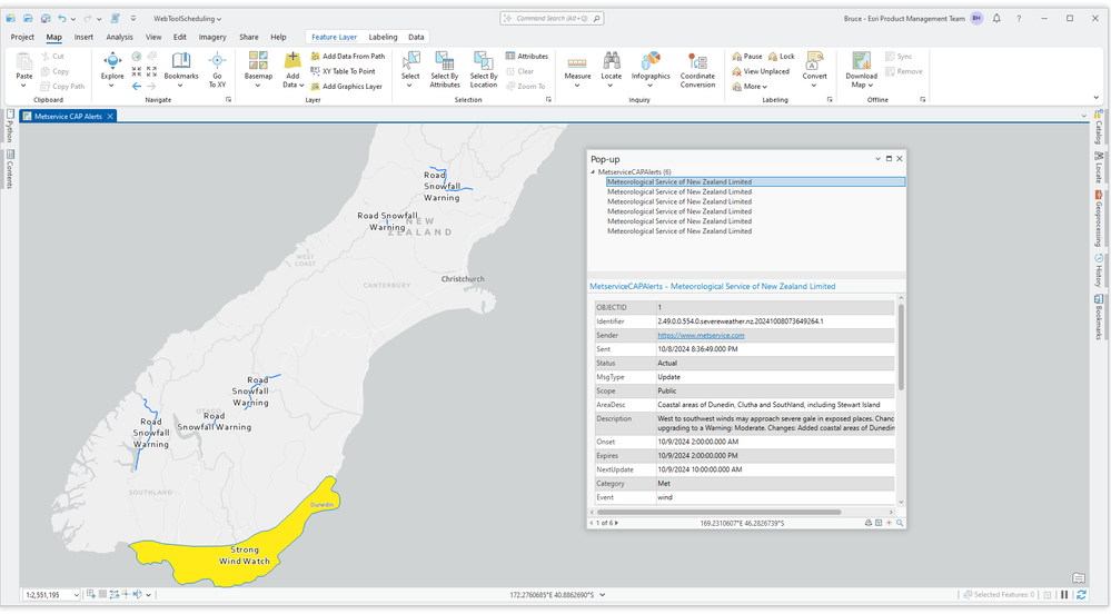

As the labeling suggests, the yellow feature is a high wind watch, the blue lines (zoomed in, orange polygons) are snow warnings for roads through some mountain passes.  If we zoom in to the northernmost feature we can inspect it.  It is Lewis Pass, which has two geothermal spring resorts along the route, so if you do get delayed by snow you can wait it out in comfort!
Snow alert through Lewis PassSnow alert through Lewis Pass

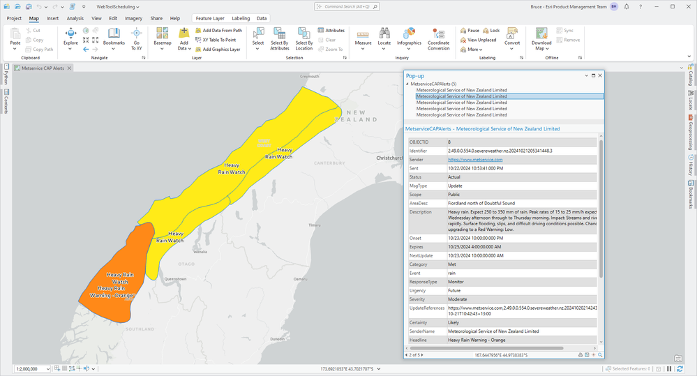

A few days later, there is a heavy rain watch:
Fiordland rain watchFiordland rain watch
For the area, rain only comes in one type - heavy - so it's no surprise the prediction of an alert upgrade from watch to warning (orange) became true at the next update in 12 hours, plus some new alerts arrived:

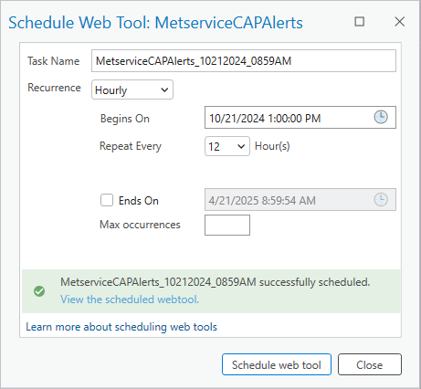

Having run my ETL tool locally in ArcGIS Pro I can share the history result as a web tool and schedule it.  There is some mental arithmetic to do when scheduling.  The CAP feed is updated by 9AM and 9PM "local time" which at writing is NZDT, or UTC+13.  My Pro machine is currently on PDT, which is UTC-7, so to start my schedule at the next available 12-hourly slot, 9AM NZDT, I calculate this is 8PM UTC or 1PM PDT.
Web tool schedulingWeb tool scheduling
In real life, meteorological offices allow for more frequent bulletins than my schedule above, but you get the idea.  At the link for the scheduled webtool you can pause, delete or edit the schedule.
