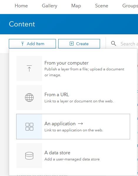

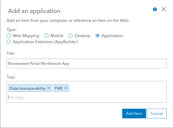

Go to your Content view and click to Add Item:
Choose 'An application' and click Application and fill in the descriptive stuff:

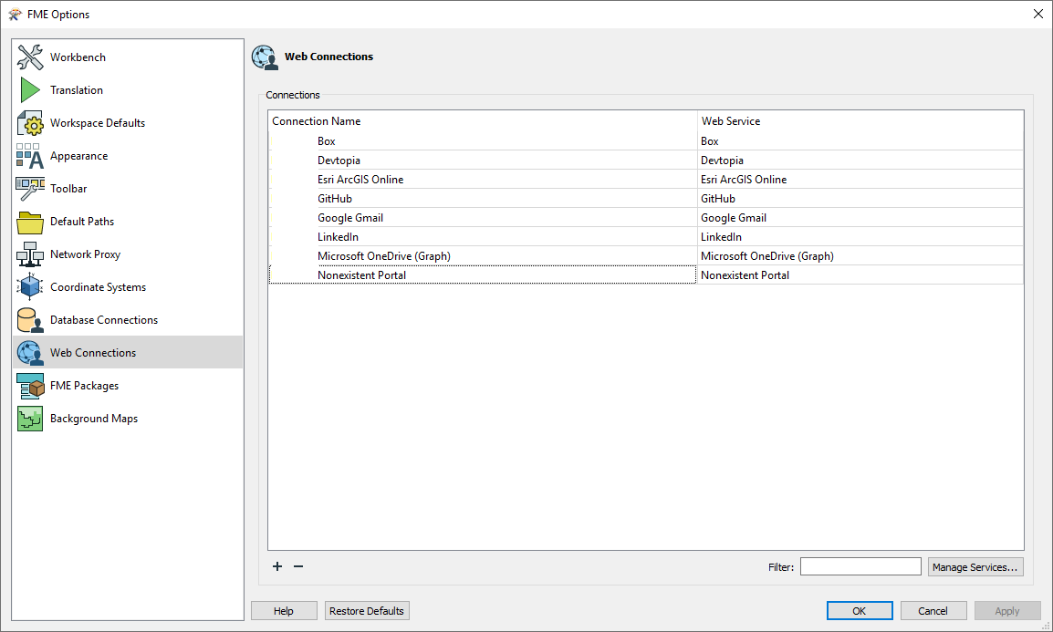

Click on Show Secret to expose the 32-character hex authentication key.  Now you have everything you need to create your portal web app connection for Workbench.  From the Pro Analysis ribbon (or by editing any ETL tool) open the Workbench application and go to Tools>FME Options>Web Connections.  Mine look like this (login obscured):

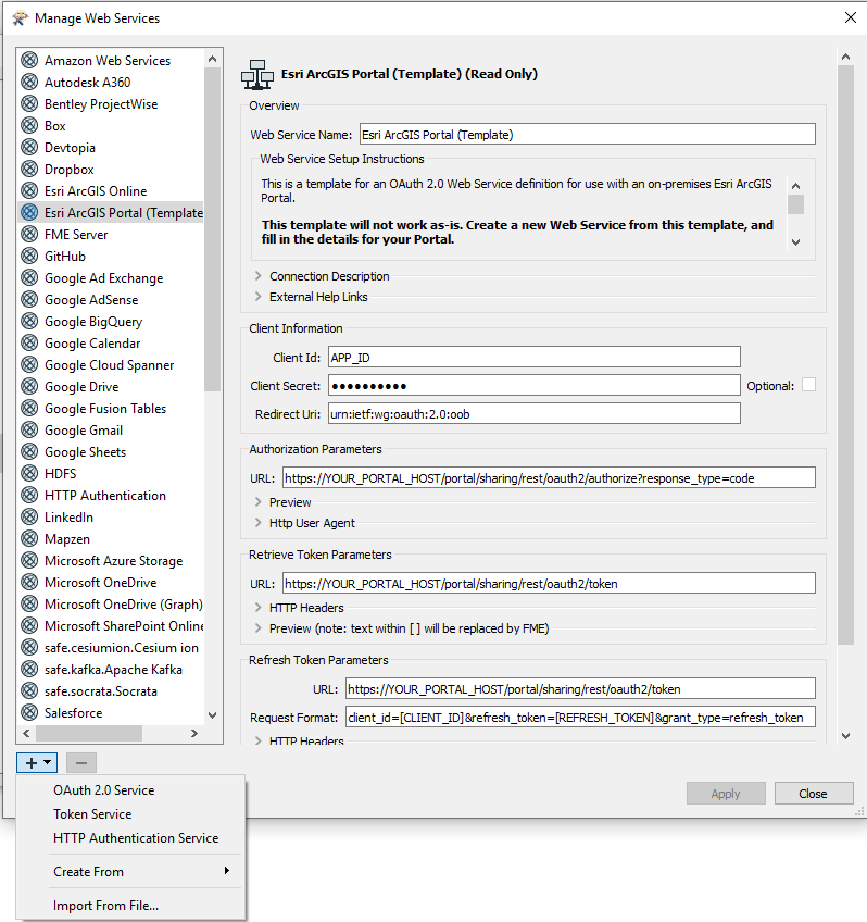

Click on Manage Services bottom right and in the Manage Web Services dialog use the pulldown bottom left to Create From and pull right and choose Esri ArcGIS Portal (Template).

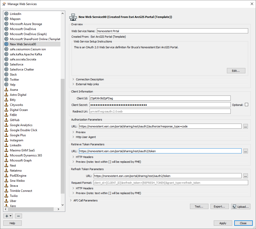

Now fill in the dialog:
Test and Authenticate, then close the dialog, and you can add a web connection:
...and you are in business!

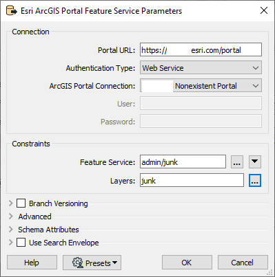

Restart Workbench and use the new web connection to add a portal feature service reader (login obscured):
Now enjoy your portal features ETL!

Hi,
I am trying to follow this workflow but cannot find the "Esri ArcGIS Portal (Template)" option. Do you have this in a file which I can import from?
BruceHarold
Esri Frequent Contributor
I added an attachment to the post but please also open a support call about the template not being available in your install.  Thank you.
AsafEvenPaz
Thanks Bruce.
I added the xml but it has a "password" section there and when I leave it empty I get an error message "
Unable to read file 'C:\Users\asafe\Documents\Metrics\portal.xml'. Most likely cause is an incorrect password.
Encryption Error: AES Decrypt finalization failed."
Thoughts?
BruceHarold
Sorry about that, I replaced the attachment with what I think is the right file for you to copy into:
C:\Program Files\ArcGIS\Data Interoperability for ArcGIS Pro\WebServices
AsafEvenPaz
Bruce,
Nearly there - I can now see this option and select it but can't find an option to change the authentication information (app_id and password)..
BruceHarold
Are you clicking the Manage Services button and then using the Create From option from the + sign bottom left?

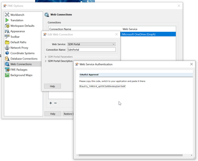

Jade_Freeman
I've followed these instructions but either when testing my new web service connection or trying to create a new web connection from my new web service connection, after clicking the Authenticate button, and logging in (via SAML), I get this screen with no way to go any further or save the new web connection.
Any ideas?

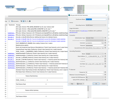

I followed this set up to access a geocoding service in Portal and it worked perfectly for a day.  I found the way to extend the Auth to 2 weeks / 20,000 minutes.  But I still have to manually Reauthenticate the Web Connection every 2 weeks.  It was great for years when I could specify a service and store a username and pw in the Geocoder. Any ideas or work arounds?  Can I automate the Reauth?
I have to stay on 3.3 because of an integration.  Thank you!!
Pro 3.3 and FME(R) 2023.1.1.1 (20231011 - Build 23636 - WIN64)
BruceHarold
Hi, unless I'm missing something, if you change your Authentication Type to Generate Token then you'll embed your username and password into the Geocoder and a new token will be generated on each run.
AllanLambert
Code 401.  You are not Authorized to access (geocoder)...Invalid Creds.  I've tried my personal creds and the portal admin.  I've tried all sharing levels for the Portal access app and the geocoder.  ESRI Support blames it on 10.7.1.  I'm upgrading in April or May.  I survive til then.  thanks for answering.
BruceHarold
Ah I see, sounds like a portal bug indeed.  You could always shell out to ArcPy in the workspace, assuming the Geocode Addresses geoprocessing tool likes your portal locator, if not then use a file-based locator.
