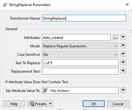

The simplest approach is to drop the fractional seconds from each date_created value.  It may be tempting to round the value but datetimes are tricky things, they are not always valid if rounded up (think 59.999999 seconds rounding up to 60 seconds, which should be 0 seconds in the next minute).
So I chop off the fractional seconds with a StringReplacer defined as below in both input streams to my ChangeDetector:
Remove fractional secondsRemove fractional seconds
Sorry to throw regex at you but sometimes it's necessary.

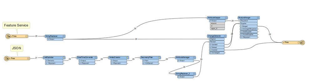

Once you have mastered change detection you'll be able to author very efficient workspaces, for example here is mine finding real changes in the fire data and writing only the updates.  You may spot that all features changed in this run (29 out of 29) which is a hint I may have more work to do...
Fire feature service maintenance with change detectionFire feature service maintenance with change detection

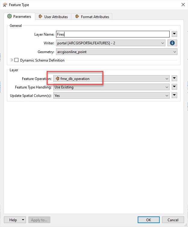

One more key point.  The ChangeDetector transformer outputs a format attribute fme_db_operation with values of INSERT, UPDATE or DELETE; when writing to feature services or databases this row-level attribute can be used by the writer to determine feature handling, set this behavior by setting the Feature Operation property in the writer - you don't have to have multiple writers for each mode.
Using fme_db_operationUsing fme_db_operation
