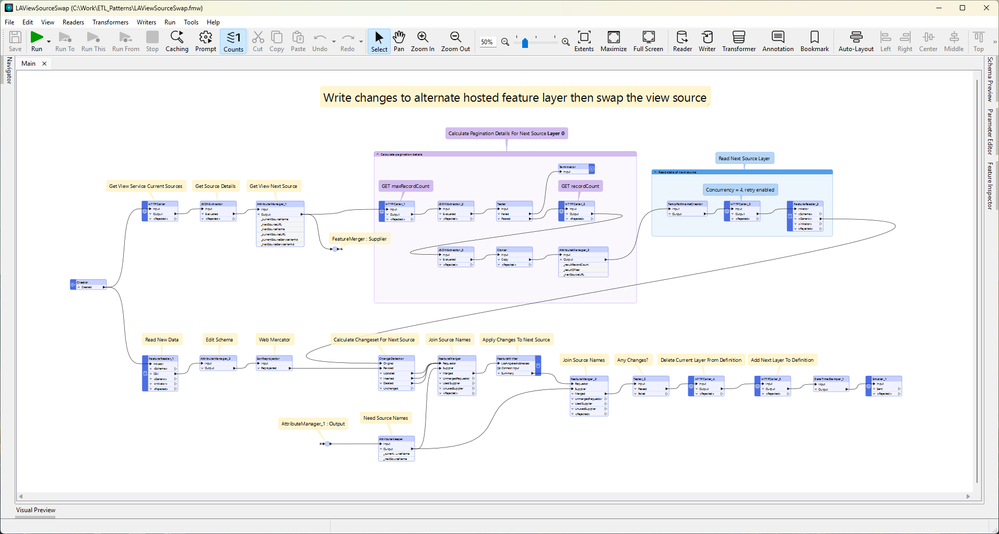

For people not satisfied with a few seconds service downtime, implementing view source swap is only slightly more challenging, see LAViewSourceSwap.fmw in the blog download:
View Source SwappingView Source Swapping
You'll see logic in the workspace to toggle between "A" and "B" services for reading, writing and source swapping.  For this reason changes are detected a little differently; the same public URL accessing the address data as CSV is read, but the delta is calculated versus the hosted feature layer that is not the current source for the hosted feature layer view, and the delta is applied to that feature layer.
Then the updated feature layer must be swapped into being the source for the feature layer view.  How?

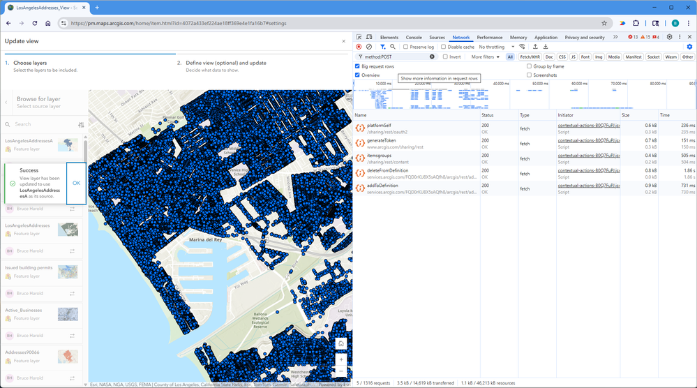

The answer requires some detective work, inspecting how ArcGIS natively handles view source swap in item settings:
View Source SwapView Source Swap
What you're looking at above is me manually doing a source swap but with the browser developer tools active, filtered to record POST transactions in big request row view.  As I clicked through the view source swap I could see the system uses two calls, deleteFromDefinition and addToDefinition.  Even better, if I inspect any POST call I can see the JSON payload used in it - which is lucky because the REST API documentation is a bit challenging for a no-code person like me 😉.
The deleteFromDefinition payload is trivial, but the addToDefinition JSON payload is huge.  However, as I made my services with default settings I'm not looking to change, I cut the JSON down to objects I thought worth keeping, and of course the required pointer to the desired source.  Here is the JSON:
