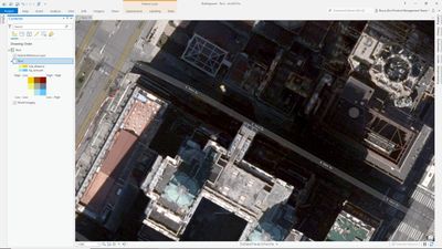

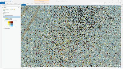

Here is what 100,000,000 features look like at the density I'm dealing with.
An extent about a city block across:
Layer not visible
Then turning layer visibility on:
Layer visible
The data is so big Pro 2.9 will not attempt to display it at scales smaller than 1:500.

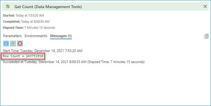

My test data is a CSV file of 143,751,910 rows.
Get Count

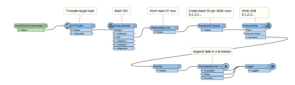

Online team suggested a 'sweet spot' for loading this scale data would be using the Append endpoint for the feature service with batches of 500K records in two concurrent processes, and run it 'after hours' US time. No problem, here are my workspaces:
LoadTaxis
LoadTaxis creates zipped file geodatabases of sets of 500K records then hands the data path off to LoadTaxisWorker in a maximum of two processes that run asynchronously. I found the time it takes to cook the data was a good fit for how long it takes Online to eat it, a little less than 2 minutes per batch during low load hours. Watching the log file go by, there were a few instances of LoadTaxis pausing for a process slot to become available, but usually Online was ready for the next batch, so things were working as fast as my ETL could run.

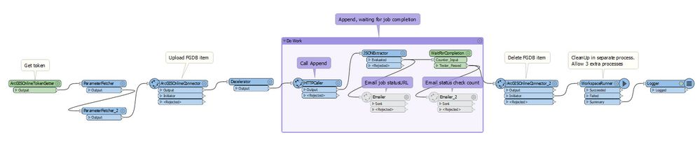

LoadTaxisWorker
LoadTaxisWorker uploads each zipped file geodatabase to Online then calls the service Append endpoint, triggering a load from the new file geodatabase item. This starts a job in Online. A looping custom transformer checks for job completion every 5 seconds (with a maximum check count of 42). Note the HTTPCaller in the custom transformer needs a concurrency setting of 1 to work in a loop. On successful completion the file geodatabase item is deleted then a second child workspace - LoadTaxisCleanerUpper - is called to delete the input zipped file geodatabase in a separate process (file handlers lock deletion otherwise).

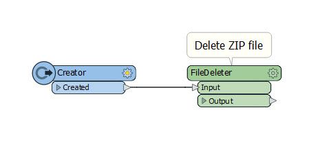

You will see in LoadTaxisWorker I have a couple of Emailer transformers (disabled in the download) and the WorkspaceRunner that calls the cleanup process allows for a bump in the number of child processes so things don't hang.

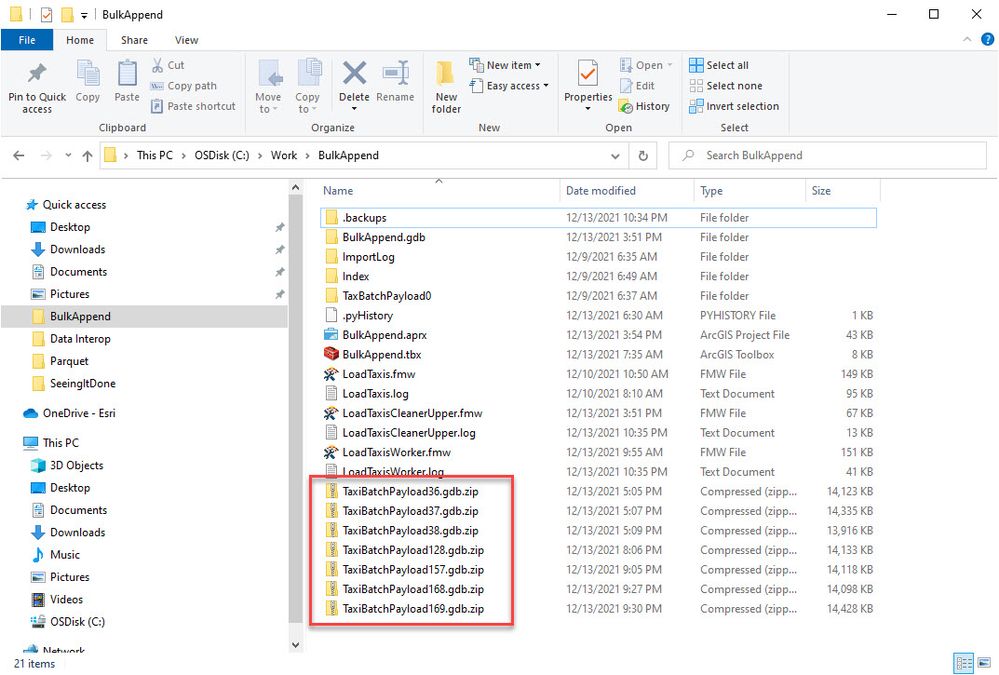

Now this being the web you can get failures even following best practices, but if you do, there is a paper trail built into the methodology. The file geodatabases made for upload are not deleted from disk or as Online items like they are for successful jobs - you can see any failed data:
File geodatabases not deleted

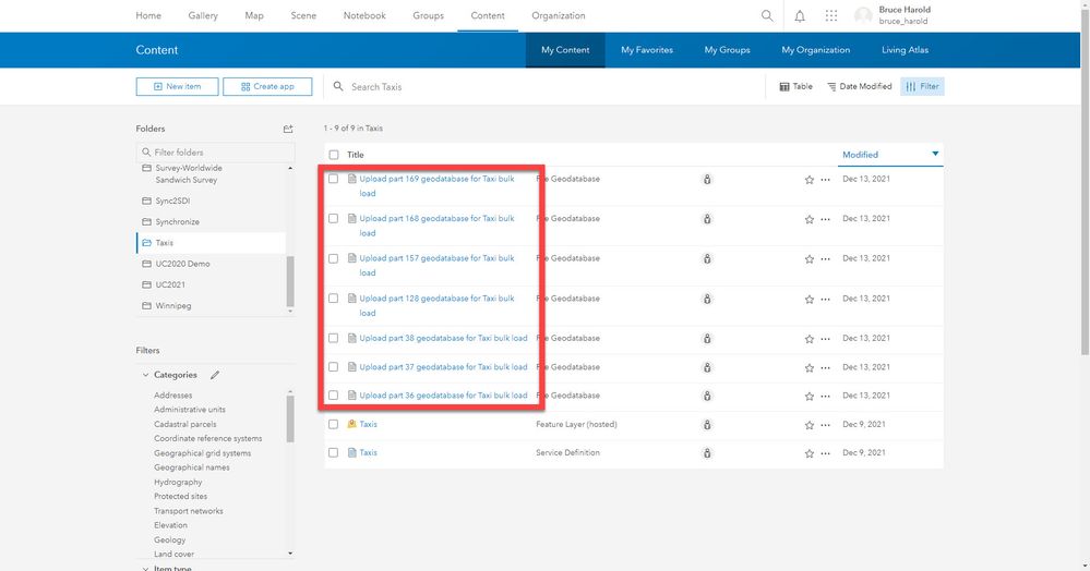

And here are file geodatabase items relating to failed Append jobs - not deleted either.
File geodatabase items not deleted

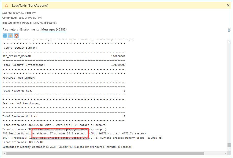

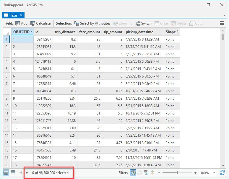

So after my hands-free run of the 100 million features, the tool executes without error...
LoadTaxis worked fine

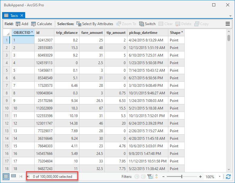

...but the loaded feature count is short because of the failed jobs:
The target feature service didn't get all data
We can see 7 failed jobs equates to the missing 3,500,000 features in the service. Lets get them there!

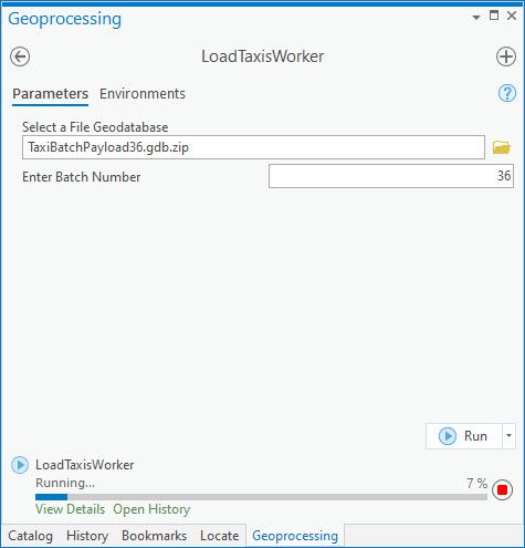

After deleting the file geodatabase items in Online I can run each job manually like this:
Run LoadTaxisWorker manually
I actually prefer to run the LoadTaxisWorker tool in edit mode (i.e. in Workbench) so I can do things like turn the Emailers on to catch the action in detail. There is also this issue to watch for which I'll put in a spoiler tag:
