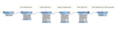

I need to add a graphic before the search engines get bored with me and I don't get indexed.  Here is a  workspace (StubOutAPIJSONReading.fmw in the post download) I used to initially explore an API (details to follow):
Exploring an APIExploring an API

Trick #1:  Using HTTPCaller.
HTTPCallerHTTPCaller
 HTTPCaller lets you simply fill in a form to make a web call and receive a response (JSON in this case).  First you must read your API doc and determine the required parameters, plus any optional ones you want, and whether to use a GET or POST method.  GET is usually for shorter URLs, POST supports longer URLs and also uploads supplied in a Body.  Another aspect is authentication.  Many APIs require an API key (like you see here) or a token.  Typically keys do not expire and tokens do, plus tokens require a generation step (which may be done separately via HTTP or via OAuth2 in a web connection you set up for your account).  My example requires a key.  My call requests a JSON array of 10 air quality measurements and returns it in an attribute named _response_body.

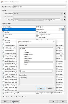

Trick #2:  Unpacking JSON
I'm headed to ingesting arbitrary numbers of air quality measurements but first I must figure out how to extract data from the JSON.  I requested 10 air quality measurements so the returned JSON will be an array.  Each measurement in the array will have the same schema used by the fields of my features - the above JSON is a measurement feature.  I need to figure out extracting field values.  The simplest way to do this is write one array feature's JSON to a file and use the data-aware capability of JSONExtractor to let me build queries without coding any JSON queries.
If I temporarily set the JSONExtractor to read from a JSON file then I get a handy-dandy picker to build my JSON queries.  Then I can copy-paste the JSONExtractor into a production tool, set it to read from the incoming feature's JSON attribute it will extract and expose all the available field values.  How easy is that!
Here is my JSONExtractor while I'm reading from a file and I'm building my queries:
JSONExtractorJSONExtractor

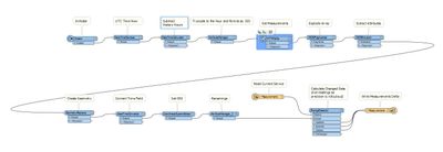

Clarity2GDB.fmw uses the JSON exploration done above to write out a feature class in my Pro project's home geodatabase - there is some renaming of attributes done, and of course they get their desired types set when writing.
Clarity2GDBClarity2GDB
Then after creating my feature service from the geodatabase feature class I can recycle the work to maintain the feature service with RefreshClarityService.fmw, which only differs at the writer step. You'll notice only changed features are written to the target service, the workspace has a parameter that sets the history interval for my features, features in the service older than that get aged out.
RefreshClarityServiceRefreshClarityService

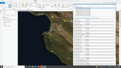

That's it!  I have conquered the complexities of web integration and have a feature service I can use to power my maps, apps and dashboards.
Feature ServiceFeature Service
