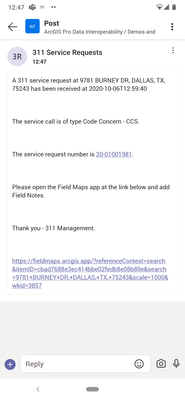

First the obligatory screen grabs of live action on my phone showing job receipt and field map response:
An incoming job in Microsoft Teams Mobile:

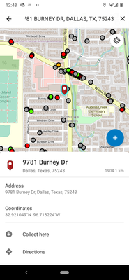

Field Maps Mobile opened from the map link:

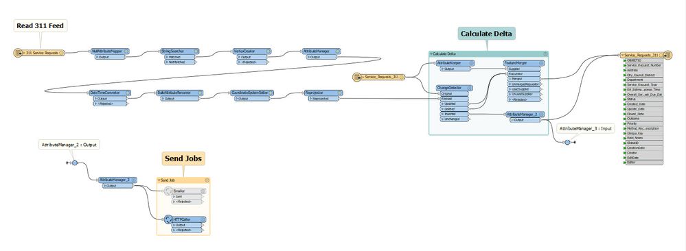

I recycled the Socrata feed from the post I refer to above for my field map data.  The web map having this layer I configured to refresh on a 1 minute interval as we could be working in near real time in the field.  The ETL tool is in the blog download but here is a screen shot:
WorkbenchWorkbench
The tool reads the 311 feed (you might be reading anything) and synchronizes the state of the data with a hosted feature service.  Then inserted (i.e. new) features each trigger a post to a Microsoft Teams channel webhook (you will have your own business logic on which data events trigger which field map response).  I include an email option too, which is disabled in the image above.  You might use a number of messaging options available in Data Interoperability.  Everything hinges on constructing a map link according to the rules in this topic at the field map links entry.
