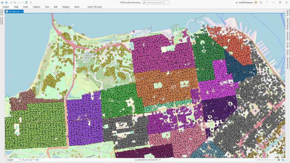

San Francisco Locator Data From SocrataSan Francisco Locator Data From Socrata

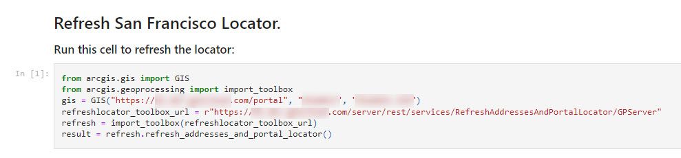

At this point we have a web tool that does what we want, now we need to orchestrate it on a schedule.  For this we use a hosted Notebook in ArcGIS Online.  This is the first notebook I ever authored (my no-code background shows) so if I can do it you can too.  The web tool runs on my portal but my notebook runs in Online.  That is no problem for the notebook, the web tool isn't executing in Online, under the covers the notebook is just authenticating to the portal and sending a submitJob REST request.  Online notebooks know how to connect to portal GIS instances.  Here is the single-cell notebook (Standard runtime):
Online hosted NotebookOnline hosted Notebook
 How hard is that?  Crazy simple.  The hardest part was getting a certificate from the IT folks that the portal would accept when hearing from ArcGIS Online (my colleague Renato S. gets the credit for that).  All I did was read the help and replace help examples with my paths and names.  To find the function name to use after importing the web toolbox I just put the code into IDLE so intellisense could give me the methods.
Then while editing the notebook I went to the Tasks editor and set up my notebook to run weekdays at 6am.  Note that the task editor time picker uses local time values from your browser client.

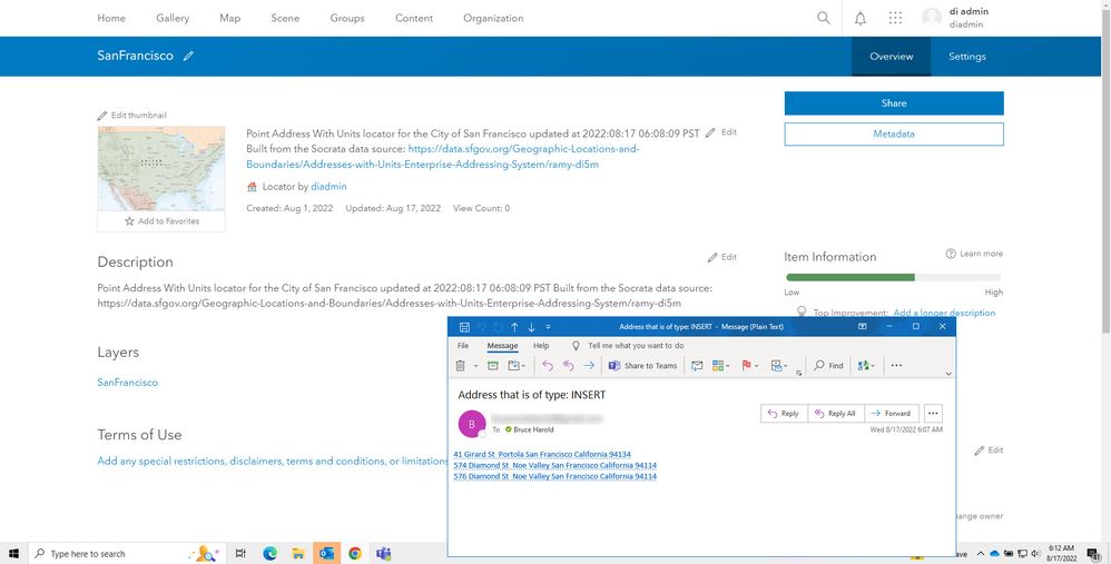

Now I can let the system(s) run and each day my organization has an up-to-date locator maintained in a portal!
Locator item details plus today's address changes emailLocator item details plus today's address changes email
