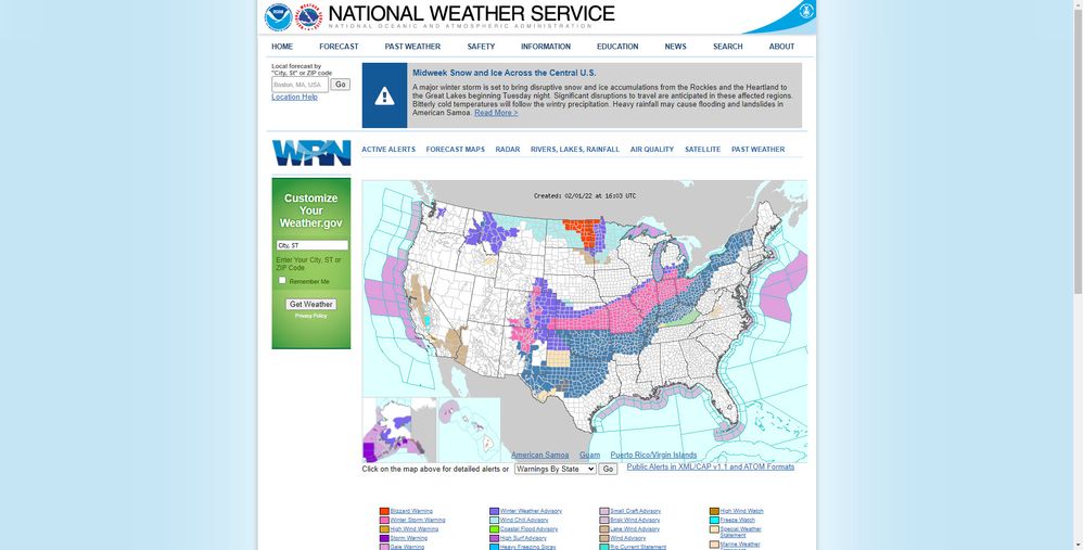

Data like the current US weather can be queried at a location:
National Weather Service ReportNational Weather Service Report

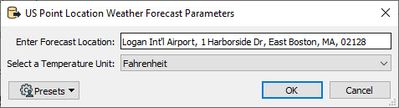

Anyone can do this with Quick Import if the weather site response is made a custom format.  I did this, so the Quick Import input dataset format gallery lets me pick US Point Location Weather Forecast format and set its parameters (any address, location or POI in the US will work, under the covers it uses the World Geocode Service):
US Weather FormatUS Weather Format

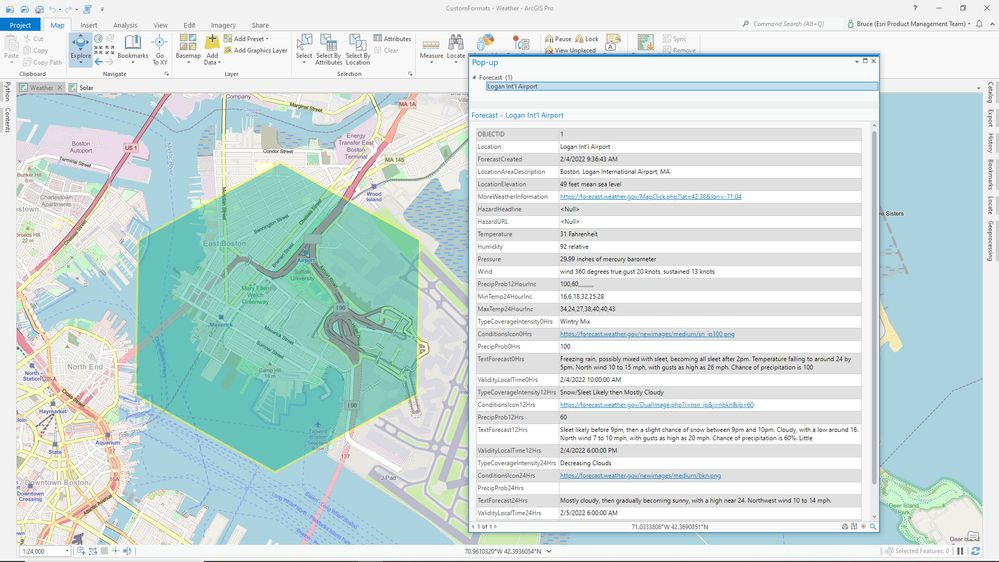

Then a Forecast feature is available to map and query - the green hexagon is a weather feature:
Boston Weather FeatureBoston Weather Feature
Spoiler
This is not relevant to the story of custom formats, but the feature is a hexagon because I used an Uber H3 encoding of the XY value geocoded from the input.  This complies with terms for non-storage use of the geocode service - all I know is the geocode XY is somewhere inside the hexagon.  The hexagon size (i.e. H3 index scale) also agrees with the coverage NOAA's NWS service returns for a point forecast.

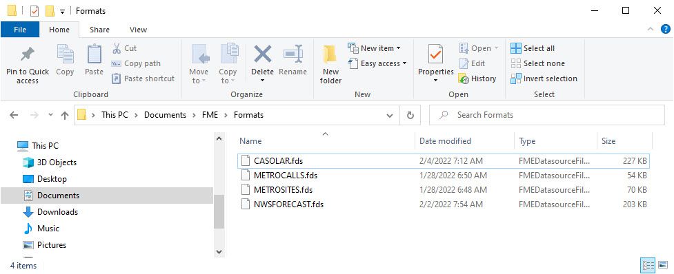

Once you have configured your workspace and verified it creates data correctly, the File menu in Workbench has a choice Export as Custom Format.  This saves the workspace as a format definition to a default location in your profile directory with a short name and long description you can see and search on in the formats gallery.  The format definition has the file extension '.fds' but it remains editable with Workbench.  These fds files can be shared with anyone either by copying into their profile directory or putting on a file share they can see - the Tools>FME Options>Default Paths dialog allows you to specify Shared FME Folders where your team can share fds files and other resources like credentials.
Here is my profile directory with a few custom formats in it:
C:\Users\<username>\Documents\FME\FormatsC:\Users\<username>\Documents\FME\Formats
Two of these files are in the blog download, NWSFORECAST.fds and CASOLAR.fds - the file names come from the short name you give the format at export time.  If you copy them into your C:\Users\<username>\Documents\FME\Formats folder (make it if it isn't there already) you'll have two new formats!

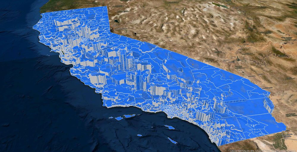

Here is the data at writing summarized as total system kilowatts per ZIP code and extruded as 1Kw = 1m:
California Generation Kw November 2021California Generation Kw November 2021

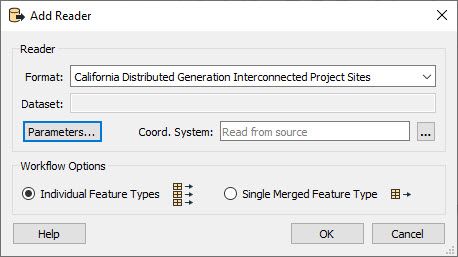

If you want your own copy look for this format:
California Generation FormatCalifornia Generation Format

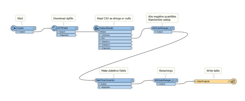

I chose to make these example custom formats from underlying XML for the weather format and CSV for the power generation format, partly because XML and CSV (along with JSON) are frequently encountered but also because in this case they are delivered via HTTP, not a dataset reader, and I wanted to show you how to do that.  To meet the condition that a custom format workspace must have an input dataset I used a special format called NULL, which as the name suggests does nothing.

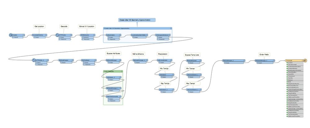

If you edit the fds files you'll see nothing special.
Weather format workbenchWeather format workbench
Solar projects workbenchSolar projects workbench
