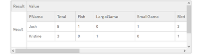

Anyway, I threw some sample data into this, and got this result:
Should be more than enough to get those popups.

KristineHubenig
Thank you Josh, it populated my list perfectly! And thank you for taking the time to explain the steps and logic out for me, I hope you have a great week!
